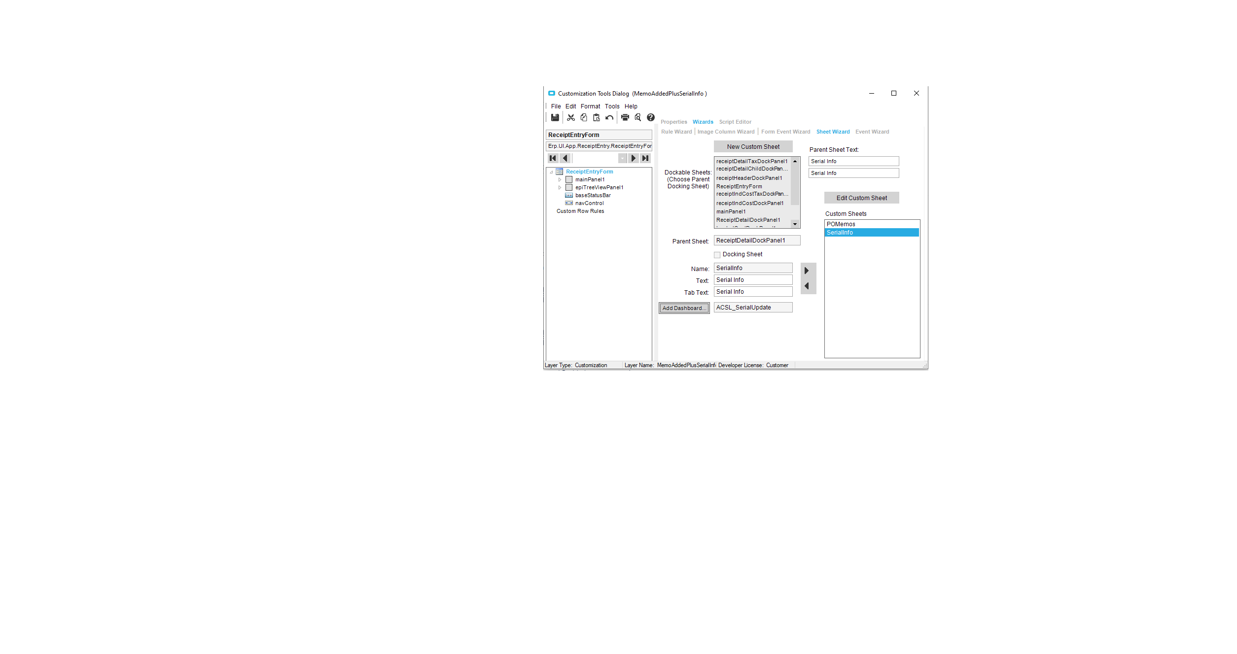

Hi everyone,
This does not seem to be the case. Please see the steps that I followed:

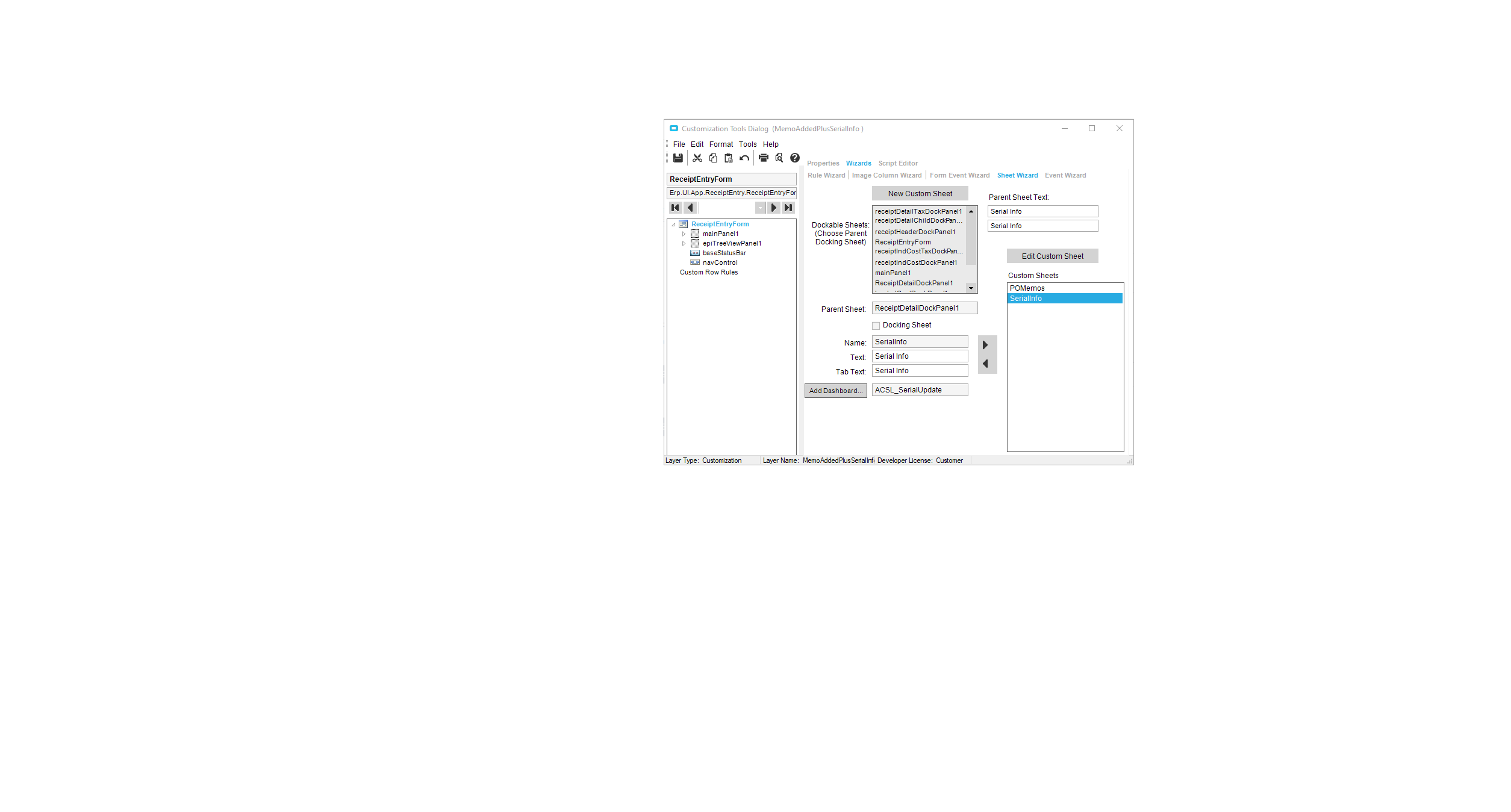

In your second screenshot, you need to choose AppBuilder Panel, and then supply the Menu ID for your deployed Dashboard Assembly…
I concur
You are both right
It is now working
