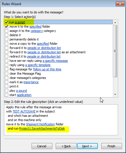

The script should be called as a “run script” action in an Email rule that detects the appropriate email message.
Here is a screen shot of the rule (it’s Outlook 2007 - Please don’t judge :wink: )
And credit to How to automatically download/save attachments from Outlook to a certain folder? where I found the VBA code (I added the sequential numbering though) How to create the VBA module is in that link.
