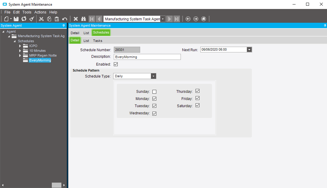

I need to send an excel every morning with the results of a baq. I already created a new system agent schedule and a BPM (data - standard - SysAgentSched) to fire up when the agent is changed.

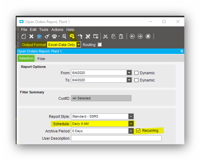

If you create a BAQ Report that displays the information you need from the BAQ, you can schedule the report to send and it will send an email with an xlsx attachment.
Create a System Agent schedule that you want the email to go out on. Then in the report options select that schedule, set the task to Recurring, set your output format to Excel or Excel Data-Only, and use the Email Report button to set your email options. Then, the report data should send out on your schedule as an attachment to the email.

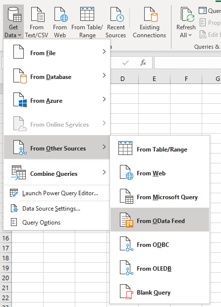

You can put in your link in Excel OData Data Feed:
Of course, if you wanted to add extra security you could use v2 for your link.

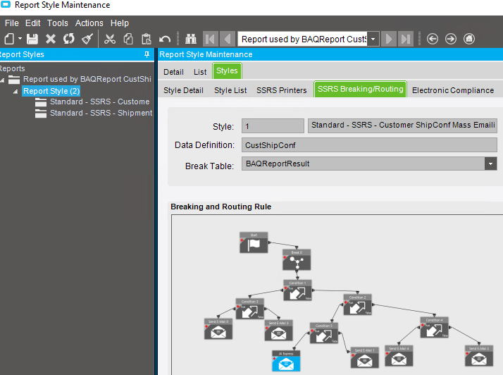

And then you use SSRS Breaking / routing, and use the graphical designer to create an email.

This is an example with lots of possible different emails
Here’s an example of the email template inside the breaking / routing designer. The BAQ report is automatically attached. It just comes from a table inserted in the SSRS report designer.
