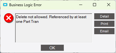

Im having a hard time understanding how you have a large repository of parts deleted out of Epicor, as once a part has been in any sort of a transaction it can’t be deleted.

Epicor will not let you delete a part UNLESS it is not yet referenced by some other table… for example, once you create a job for the part, you cannot delete it.
That said, this is somewhat self policing…
But there is the possibility that someone could create a part, part revision, BOM, and never reference it elsewhere, and then delete the part. If you are trying to track this, then, NO we dont have a built in way to do this.

Indeed I am not able to detete the part that has reference to other table.

Once there’s a transaction against the partnumber then it can no longer be deleted. You would need to go to part maintenance and check the inactive checkbox to prevent the part from being used going forward.

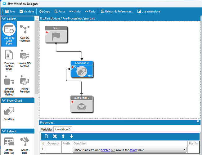

You could create a BPM on the Deletion of a record from the part table. But I think that might require some custom C# in the method directive (BPM setup) in order to write to a UD table.

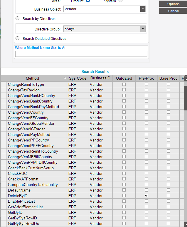

The challenge I have is that I don’t know which method to use for deletion.
Example, if I want to track who delete the Vendor.
In the Vendor business object, there are many methods and I tried a few of them and it doesn’t seem to work.
Likely it would be update or updateext. You can run a tracelog and create / delete a vendor in your PILOT environment. Then on the tracelog record it should show the business object and method used for the vendor deletion.
If you’re trying to make a BPM you can do a data directive and create a condition that triggers the BPM with the condition that ‘There is at least one Deleted row in the ttVendor table’. Then you can Execute custom code that will write to the UD table at the moment the vendor is deleted.
Even DeleteByID() usually ends up calling Update().
You just add a new BPM on Update that triggers whenever Rowmod == “D”
You can also use a data directive. For parts, both method and data directives are going to be pretty much identical.

I managed to get it work using the update as per say.
Thanks John,
I did try to use RowMod == “D” but without success.
Maybe I am missing out something.
However I managed to use “There is at least one deleted row in the xxx table” working.
