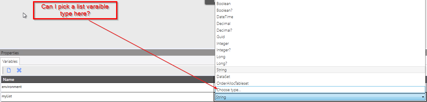

Is there a way to create new DataType in BPMs for Variables?
I have a linq query that sets a list variable to a nice ordered list. Is it possible to set a global bpm variable to it, instead of having to write the same query out in 2 places?

I wonder if you can just assign it to “DataSet” using expression and use that?
// going to assume this will be just null and not work, but perhaps something similar to it. I am sure there are posts out there to Conv List to DataSet
myvar = (DataSet)(new List<string>(){ "a", "b"}).AsEnumerable();
