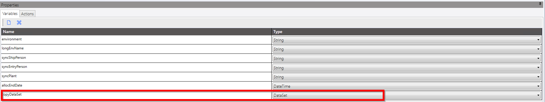

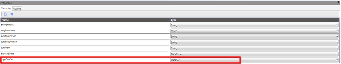

1: BPM Variable of type DataSet:

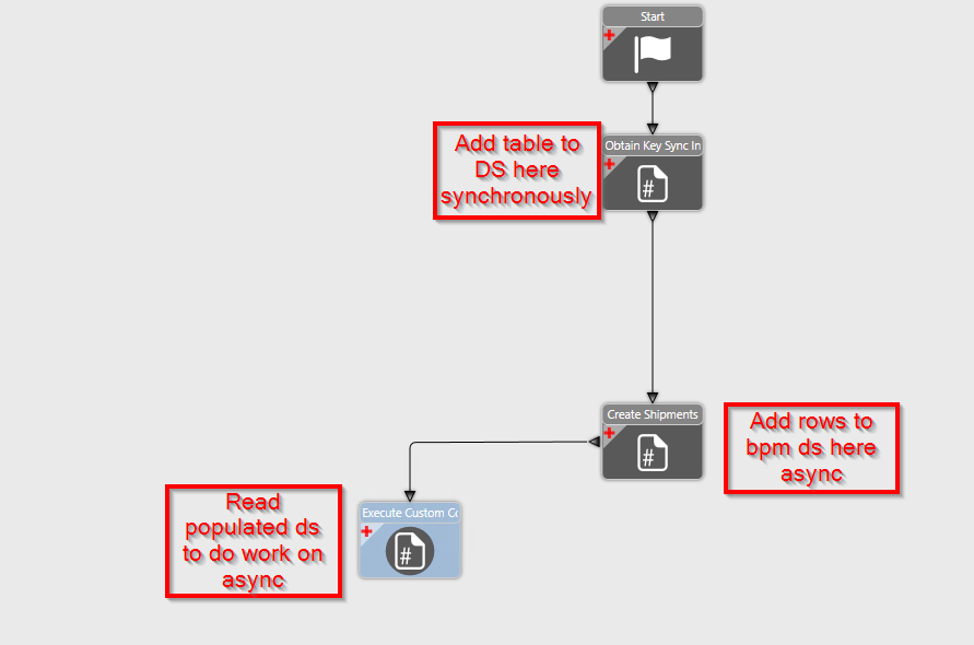

Overview of flow:
The rows get added to the ds just fine in async code block 1, but when i attempt to access the same ds in async code block 2 (the end one) I get no rows.
