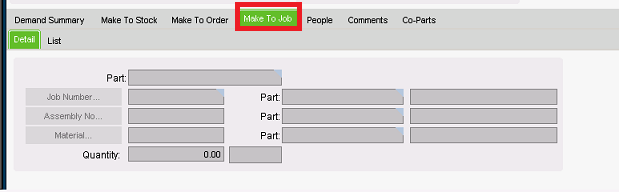

Might be a pain but… wonder if you could rework your methods?
Break out problem ops like this - separate as bub jobs - demand type “make to job”. Give you more control over releasing to mfg?
