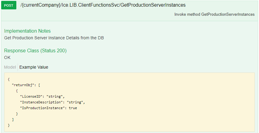

In the Client Functions library, there is a GetProductionServerInstances service…
Not sure how the Instance Description is set though…

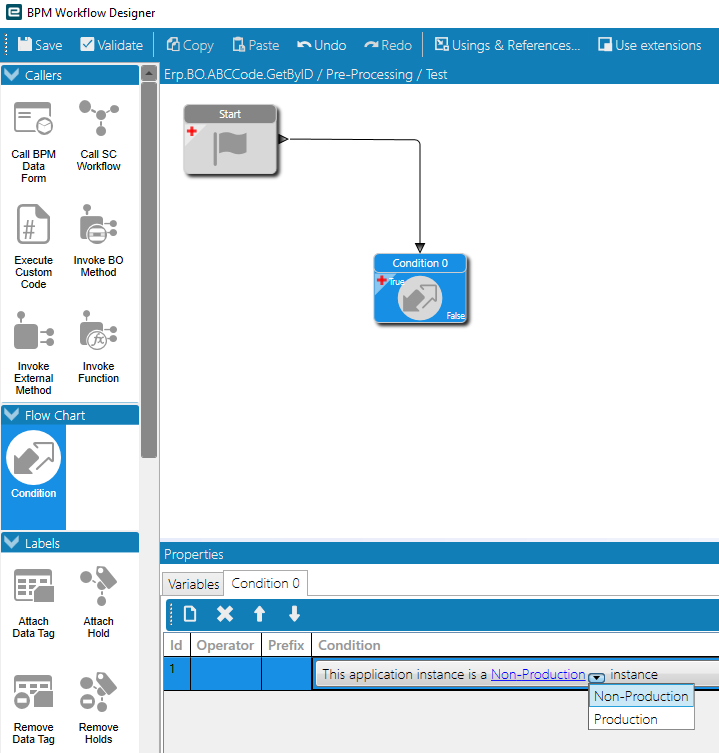

If you’re just looking for Production or not and you or the Epicor Cloud Team is maintaining the Production Flag in the Admin Console, AND you’re on 10.2 or higher then BPM’s have a built-in condition for checking this flag:
For people at 10.1 and below, one can search for certain text in the Company Name and do a regex like you did above.

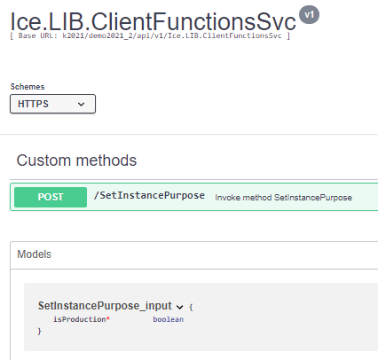

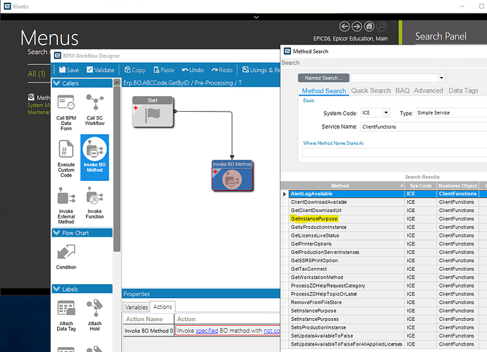

BTW, at some point, maybe 2021.1 but certainly 2021.2, there are also GetInstancePurpose and SetInstancePurpose methods in the Client Functions service in addition to the IsProduction setting.

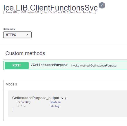

I’m not sure what the intended use for this by Epicor but it appears to just be a boolean and it has the same property as IsProduction? :thinking: If it were a string, it would be easy to set the purpose of non-production instances and solve this problem - even for SaaS MT!!!
Maybe the Open-API Schema is wrong here… :man_shrugging:
