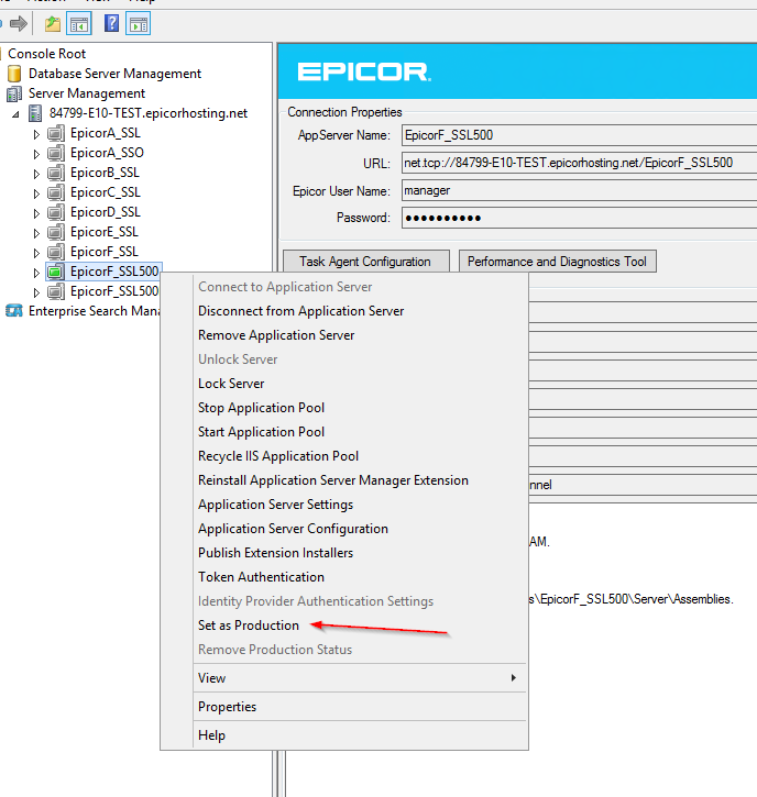

Under Consideration - in 10.2.500
Potential Solution spotted in the Wild! 10.2.500+
Profiler shows it updates the SysLicense table Ice.SysLicense to IsProductionInstance =1
UPDATE [Ice].[SysLicense]
SET [IsProductionInstance] = @0
WHERE ([SysRowID] = @1)
SELECT [SysRevID]
FROM [Ice].[SysLicense]
WHERE @@ROWCOUNT > 0 AND [SysRowID] = @1',N'@0 bit,@1 uniqueidentifier',@0=1,@1='0F0F9164-880E-4ABE-B8FE-21F9AF7A02CA'

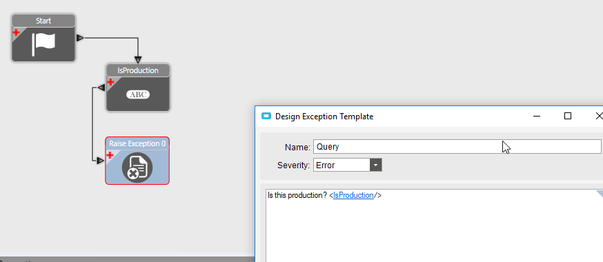

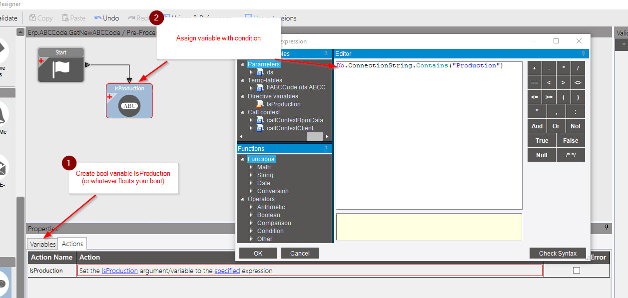

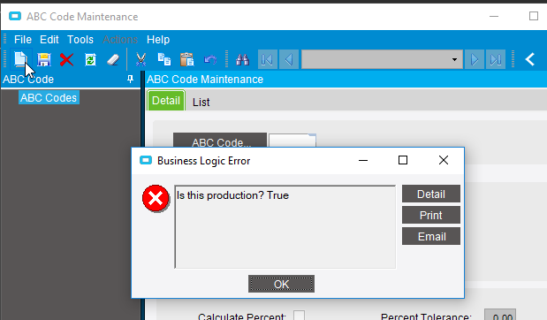

Further more it was added to the BPM Condition Workflow
THANK YOU @Edge!!!
