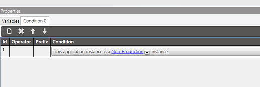

Never ever use ConfigurationSettings in your BPM/EFx custom code. You will have a lot of troubles during upgrade to the future versions of the product since this type is not a part of .NET Core/.NET 5/.NET 6/…
BPM/EFx provides a condition checking Production vs Non-Production environment.
That is what we use…
