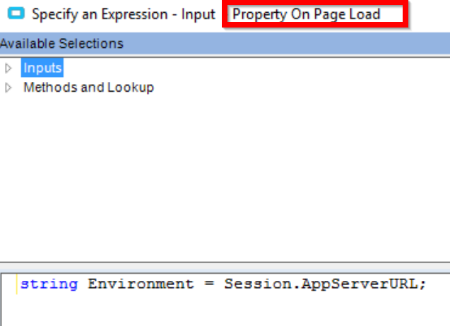

In the On Page Load you can use:
string Environment = Session.AppServerURL;
Depending on the version you could add a server side UD method to read SysCompany.IsLive to also validate.
Session does not seem to be recognized as an object. Am I missing something?
Oh. On Load. Got it. Thanks!
Make sure you are in the On Page Load event. This will not work in other events.

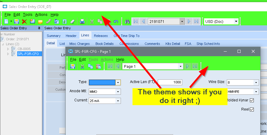

As “universal” indicator that shows in all forms, I set the default theme in my test environment to one with lime green toolbar backgrounds.
You can’t miss it, and no customization required. Just have to remeber to set the default theme each time you copy the live DB over the Test one.
Here’s an example (with a theme file link too)
And those colors appear on all forms (at least ones with toolbars), not just the main window of Classic mode.

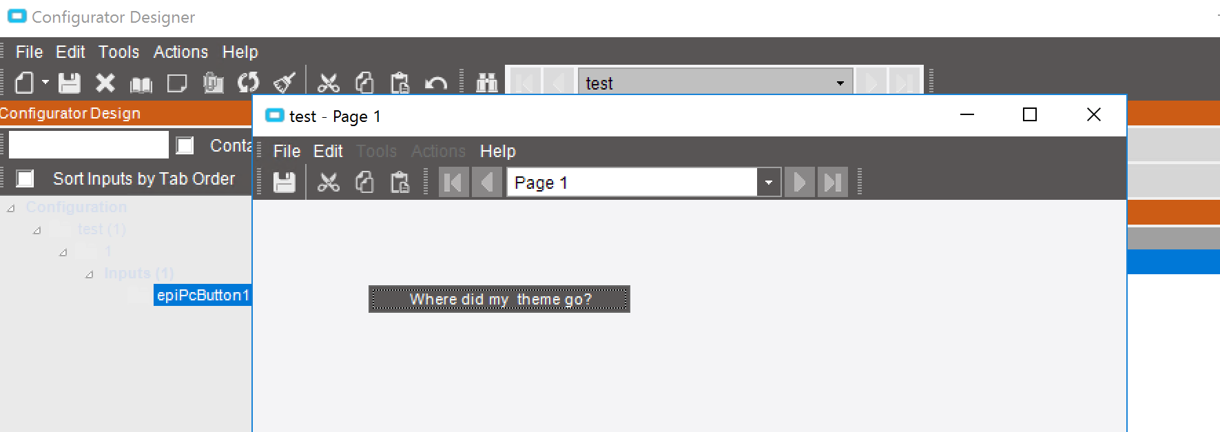

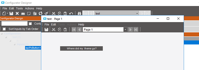

I think this depends on the use case and sometimes a single line of code is worth a thousand do not forget to do this moments on refreshes - at least for this example. I do like the use of themes in general. You could script the theme but then you are customizing, just in different way and better lock those users down so they cannot change it. If the use case is using the Prod vs. Test for larger things like URL for Test vs. Prod APIs or anything programmatic I don’t believe the theme is going to help you much. I also don’t believe the actual configurator screens follow the theme - which is another problem if you have it full screen and forget. You can see below, the theme is set for forms behind the actual configurator screen but nothing on the actual screen itself.
But yes, themes are only good for getting a users attention. Anything that is automated should use code to determine the environment.
