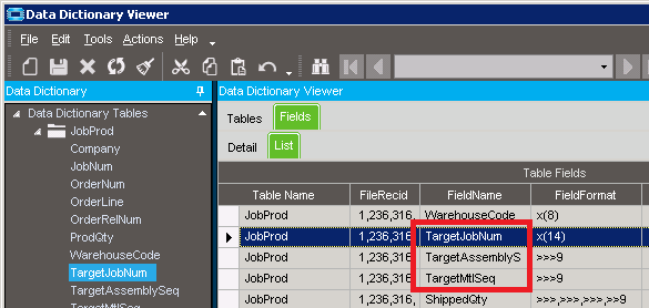

Looking through the Data Dictionary, I am seeing that there is a JobNum2 field in the PartTran table, which says it is the ‘Job Number of transfer source/target’.
I also see a field named FromJobNum in the EpiDataView[“IM”] (also present in the IM.IMPartTran table).
However, I never see data pass through either of those 2 fields when issuing material.
Is that not what those fields are intended for?
