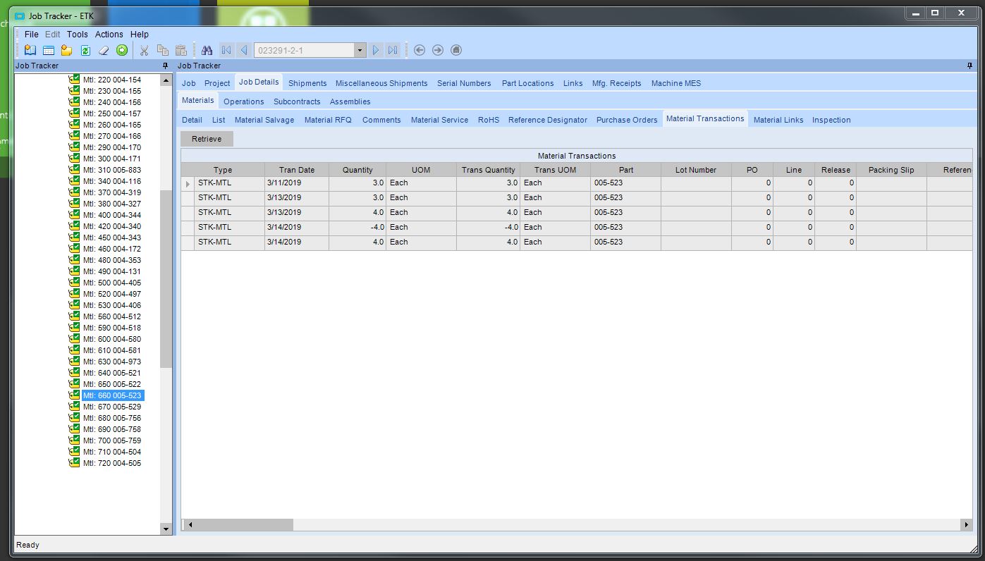

Can you screenshot the job material line transaction grid from Job Tracker. Does it show any additional transaction types?
That show only 10.

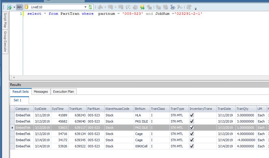

The Part Transaction History Trackers show 11

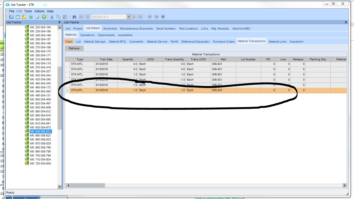

Found it. It was added to a different sequence.
