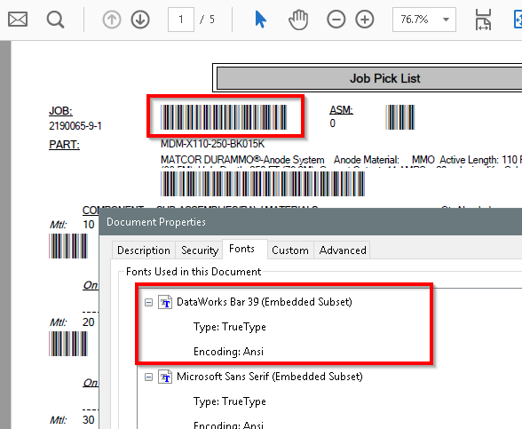

Preview the report and in Acrobat Reader look at the Fonts tab on the document properties, like:
What shows?

Perhaps this helps
