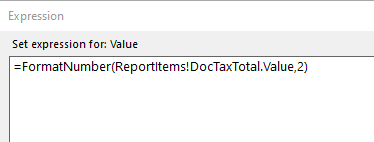

I print field data in heading/footer with the use of ReportItems!
In this example, I have a small text box in white font (called DocTaxTotal) somewhere in the grouping of where the data is available then I reference that text box name in the footer using ReportItems!
