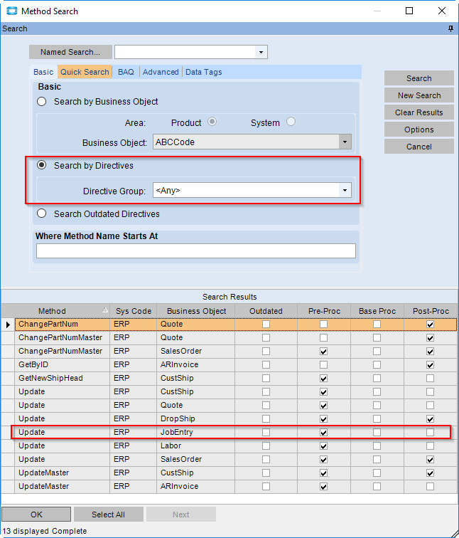

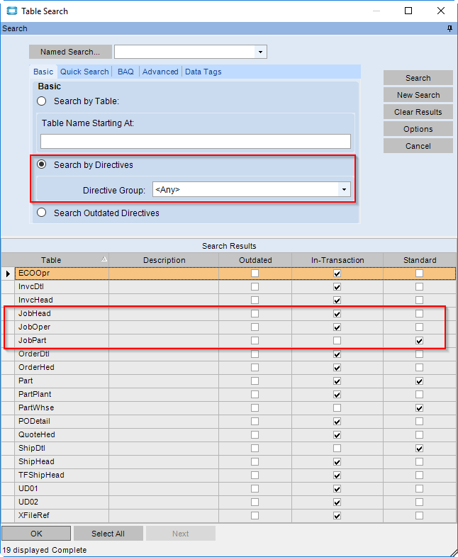

You’ll have to forgive my ignorance about the inner workings of the software, I was a general sysadmin who was thrust into this role. How would I determine what should be disabled, and how would I go about disabling it? If you know of a resource where I could learn more about this, that would be awesome too.
You will want to look under Method Directives and Data Directives:
System Management --> Business Process Management --> Method Directives Maintenance
System Management --> Business Process Management --> Data Directives Maintenance
Search by Directives and select any methods that use a Business Object related to Jobs
