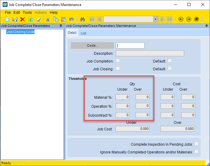

You can use the Auto Job Complete/Close process to set some tolerances on cost/qty and have them close or complete on a schedule you define.

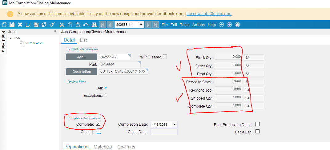

What parameters need to be set up so that, if the below criteria is met, then the job will CLOSE?
-Job is Complete
-Stock Qty +Order Qty = Prod Qty
-Recv’d to stock + Recv’d to Job + Shipped Qty = Complete qty
If the above criteria are met, then a job should be closed. We do not do full routings at this time, so I do not want to base the automated closing process on cost.
Example below - this job has been reviewed by our expediters and completed and has also shipped. This job can be automatically closed.

Ehh, the stock parameters really aren’t that specific. It’s more based on operational quantities vs shipping/receiving.
If you want something more like that, you could create a BAQ to get the candidates and then DMT to close them.

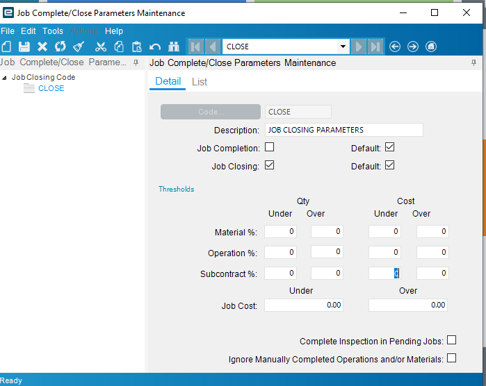

Can you share how your company has the parameters set up? If I set it up per below, does that mean that, if the quantities match exactly, the job will automatically close? I tested this in Pilot and it appears that it closed 4,200 out of 4,700 jobs. The rest of the jobs are showing in the Job Closing Exception Tracker for various reasons. I just want to make sure this is the proper way to set this up.

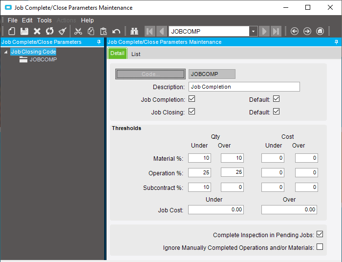

This is ours:
In other words, it will close and complete a job if the material is within 10% +/- of being fulfilled, operational quantity within 25% +/- of being fulfilled, and subcontract is within 10% under, but not over.

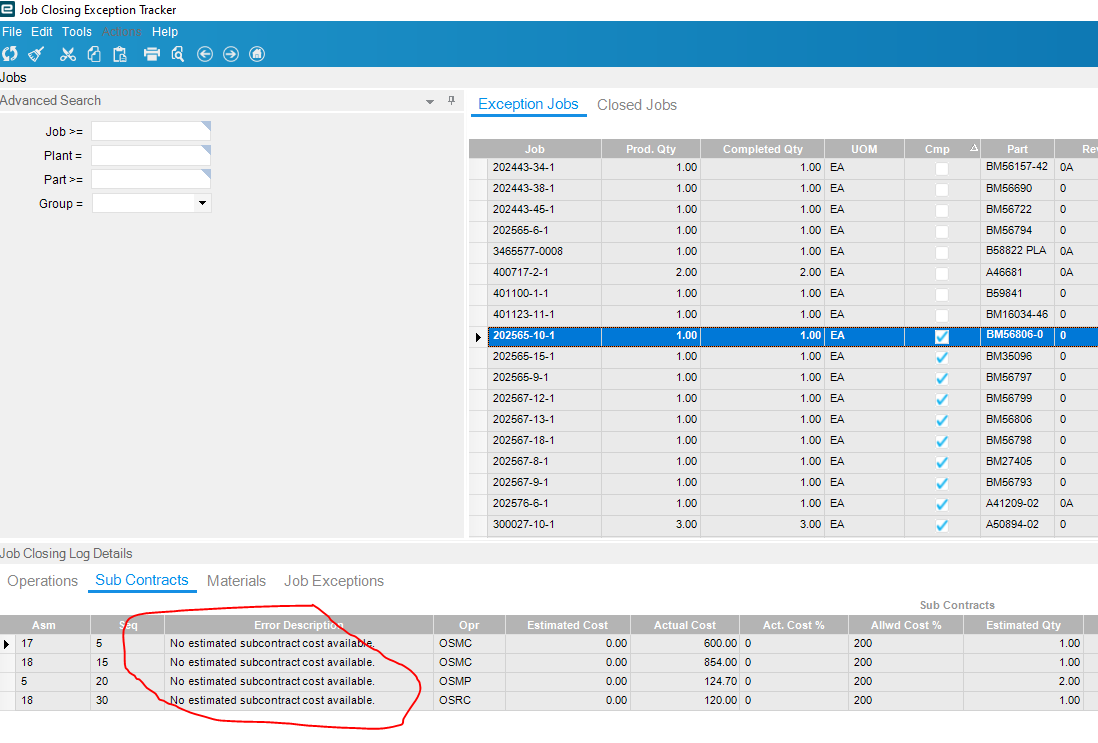

How can we setup the parameters to clear this warning message “No estimated subcontract cost available.”? We don’t enter estimated subcontract costs.
I think you can remove the subcontract cost parameter. Leave them at zero.
I did try that with no luck, unfortunately.
@lfilzen I would use a bpm to set estimated to actual when actual is updated.
