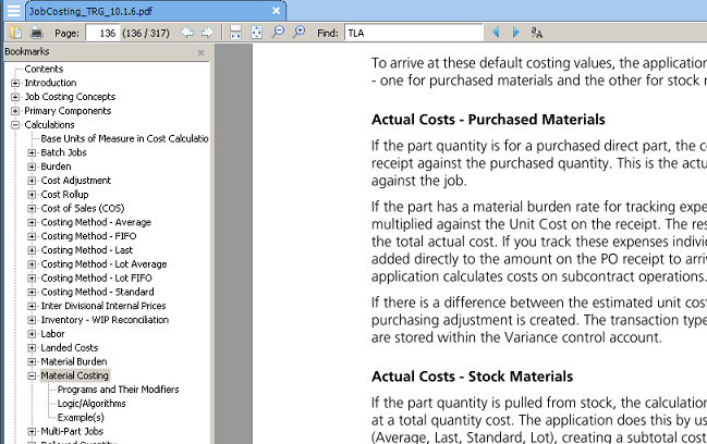

Also, have you already found the “Job Costing Tech Ref Guide” in the help system?
I usually start with this guide whenever I have questions like yours.
