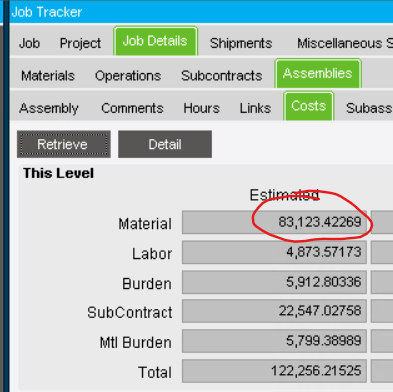

I’m working with a BAQ to compare estimates and actuals on a job and believed that the estimated material costs should be captured in the JobAsmbl table by calculating JobAsmbl.LLEMaterialCost + JobAsmbl.TLEMaterialCost. This lines up with the Job Details > Assemblies > Costs screen of Job Tracker, and some of the summaries in the Production Detail Report.
However, the Raw Materials transactions in the Production Detail Report appear to be calculating the estimate as JobMtl.RequiredQty * JobMtl.EstUnitCost, which is giving me a totally different value. (In the case of the example above, I’m getting $112,465.76 - more than 30% more).
