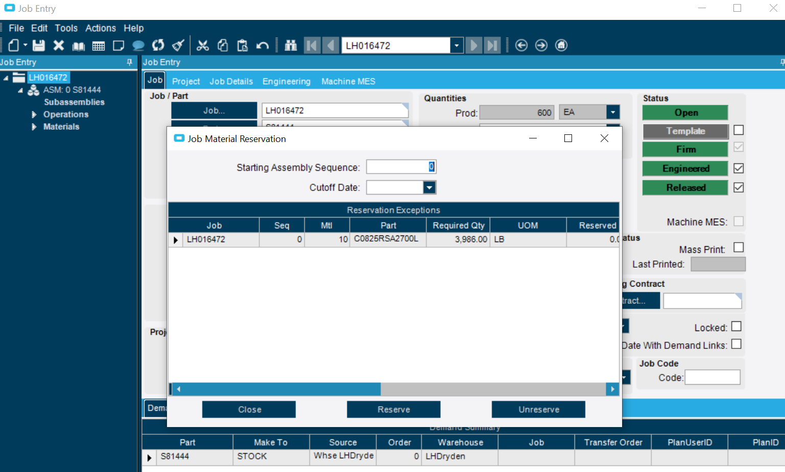

Job Entry Job Material Reservation Pop-up Window
When a Job is flagged as ‘Released’, there is a window ‘Job Material Reservation’ that automatically pops up. I would like to stop this from happening. Is this a setting within the system? I have looked everywhere. I have also looked into any BPM’s, customizations that may have been created to make this happen, but I have not been able to find anything that relates to this.
Any help would be appreciated.

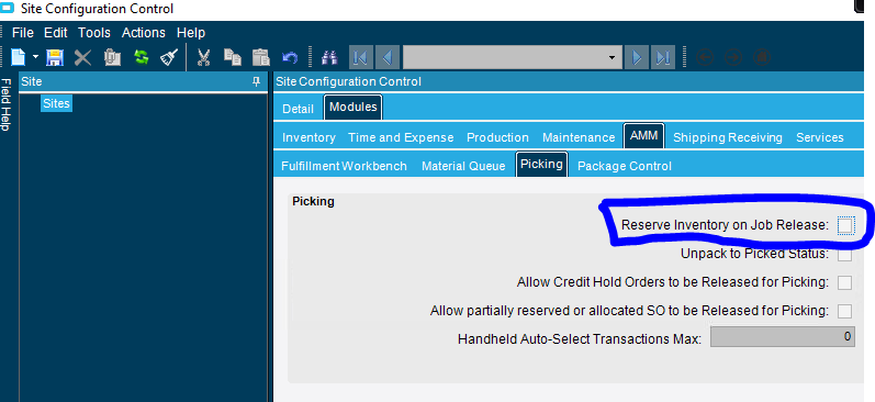

@Melissa_Good I tried to replicate the problem but couldn’t. Have you run a trace log?
@Melissa_Good
Could you cross check this check box in the site configuration, may be it is selected.
Thank you @prash172 that was it.
