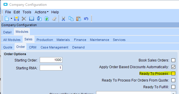

Can I get rid of pop-up messages for job links and ready to calculate on Order Entry? Also, does everyone create job links as part of the order entry process?
Hello All,
I have seen some threads for the Ready To Calculate Message on Order Entry like this one Order Entry Ready to Process Message - #10 by hmwillett - ERP 10 - Epicor User Help Forum . Has there been any developments on this “feature?” Is there any way to make that pop-up not pop up…?
Also, we frequently get the message about the order having make direct releases without a job link. Does anyone else get this? Is everyone creating job links as part of the sales order process? Is there any way to disable this pop-up?
Thanks in advance for any inputOrderJobLink ReadyToProcess . Attached are photos of the messages.
The “Order has make direct releases without” message i’m not sure about, we don’t get that one and have a mixed mode environment so I’m thinking that must have something to do with a setup param somewhere requiring jobs before an order is released? not sure. As for the Read To Process message unless you use tax connect, set it to default true in company config, remove from the screen via customization if you so choose and viola no more message.

The Ready to Process popup can be suppressed via Company Configuration
Right, but I don’t necessarily want to default it because changing it from false to true activates our tax software which calculates and adds tax to the order.
There are many times where order entry leaves the order knowing that it is not checked. They are sick and tired of having to confirm that message.

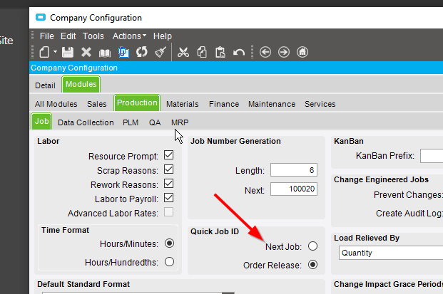

Any way I can use this but have the job be created with the order-line-release number (like in the planning workbench) and not just the next job number?
That’s what it does by default. I think that part is down to your company configuration, and then the Order Job Wizard follows whatever you’ve set.
This is the setting for that I’m pretty sure.
@dhewi @Banderson I should have known they would hide that in there. Thank you both.
