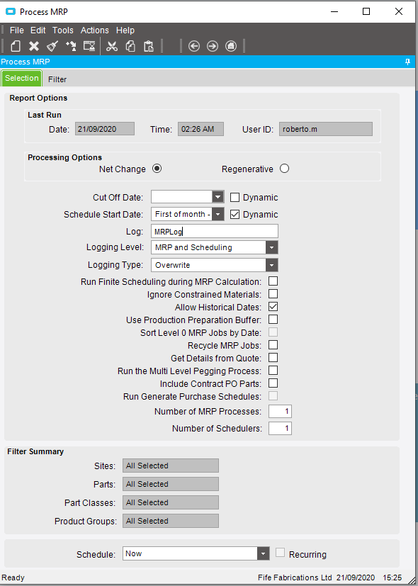

i do not calculate it, Epicor does, SC extract it and apply it, the SC bulit in logic just validate it with other issues to make sure that it is correct, you may need to review your setting for the MRP and scheduling task.

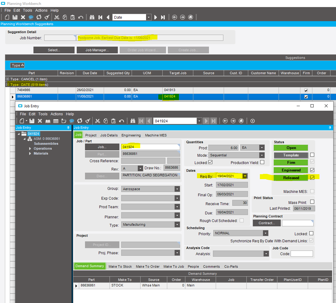

for us we succeeded to do that using this built in logic i told you about, it is working fine so far, planner trigger the process once a day, so when MRP and Global scheduling run it will put these WIP-Confirmed jobs where it supposed to be, the custom logic that working for us is very similar to Epicor which checking the nearest demand compare it to the safety and on hand stock then assign the less lead time job to it if the priority factor is the same, the WIP-lead time for any wip job is the total number of Prod and setup hours for nonstart operations plus the non dispatched subcon days-out hours plus its receive time, what ever finish sooner takes the new required demand date

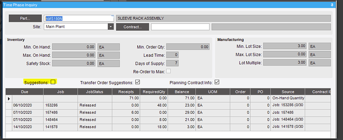

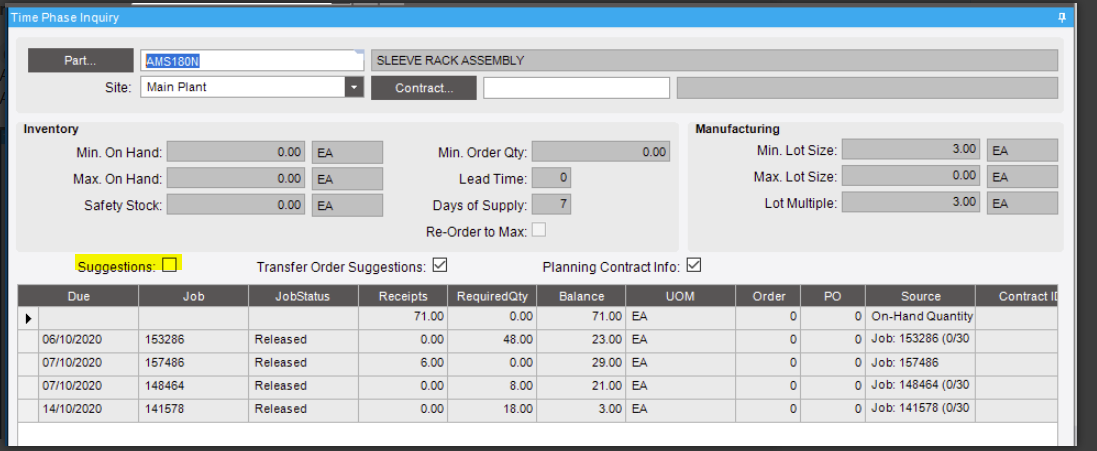

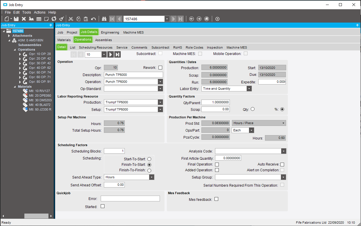

The PartSugg table does not contain a record for this Part number.
However - when I run MRP Pegging it tells me that the first demand for Job 157486 is 14/10/2020.
This illustrates my problem - hope this makes sense.

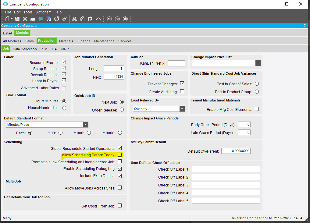

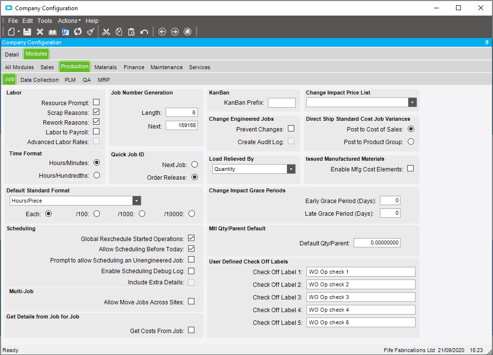

in theory Epicor scheduling engine will put them on the front of the queue and schedule them forward -ONLY- starting form its running date, unless if you ticked the Allow scheduling before today option on the company configuration

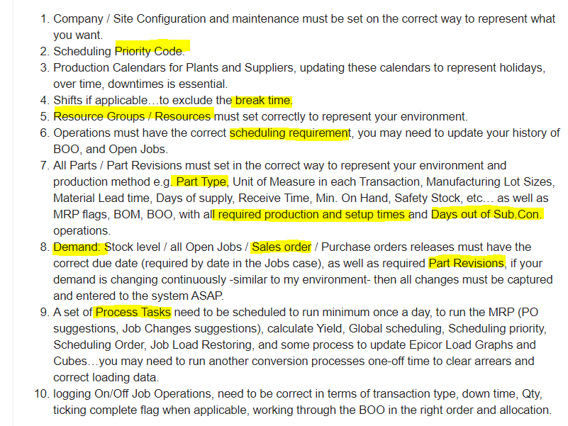

yes, these are two factors out of 14 others which explained on the post i have given you the link above, you need to check them all to make sure that you have set up the correct data for the MRP to run and suggest.

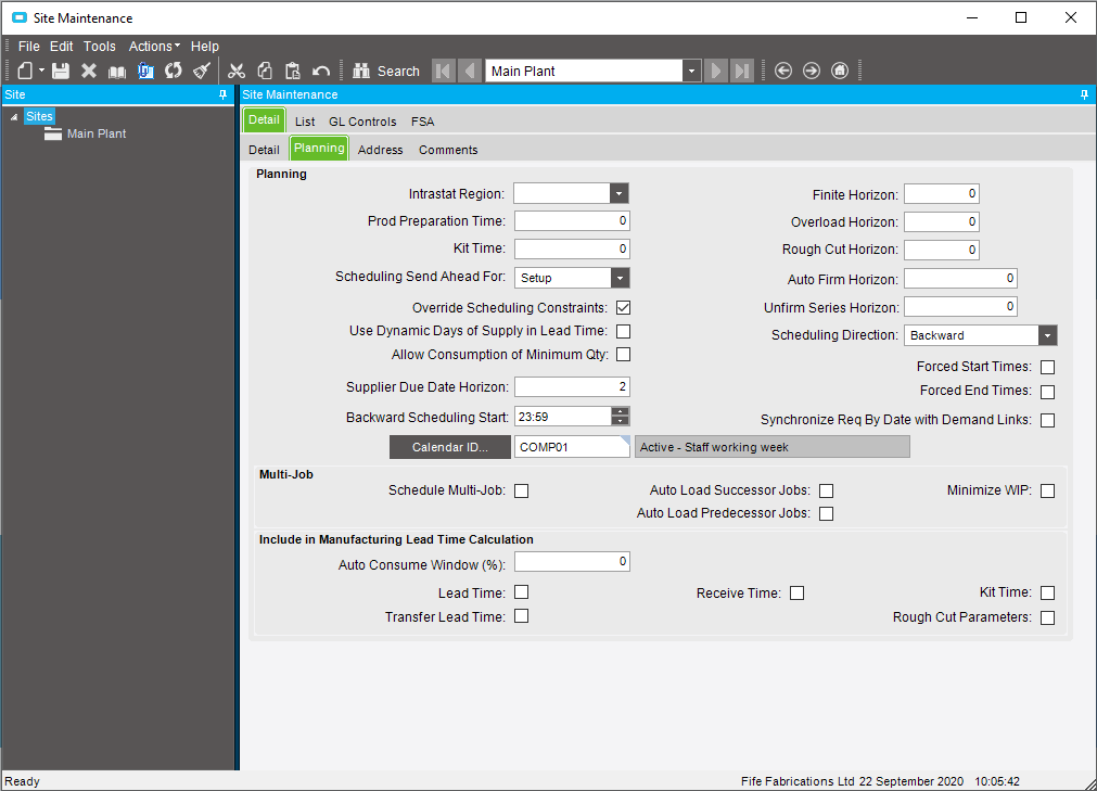

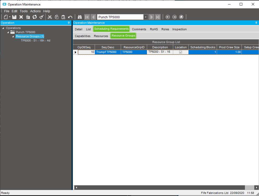

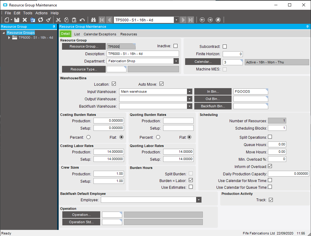

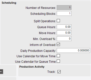

7. We have accurate Methods of manufacture - with only 1 Approved Revision per Part

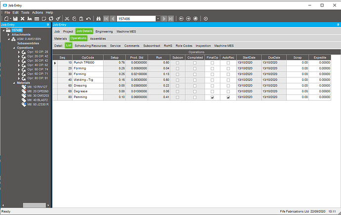

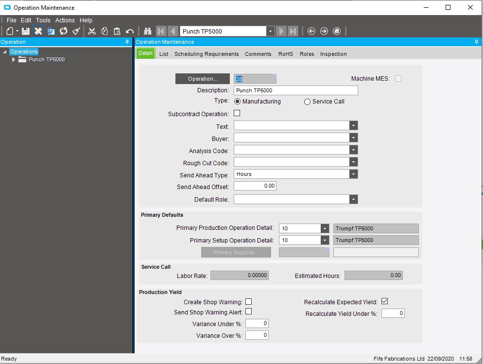

All Operations are set correctly against resources.
All required production and setup times are accurate.

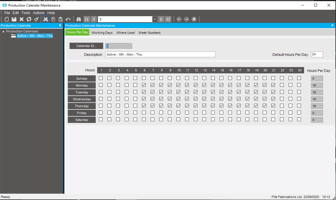

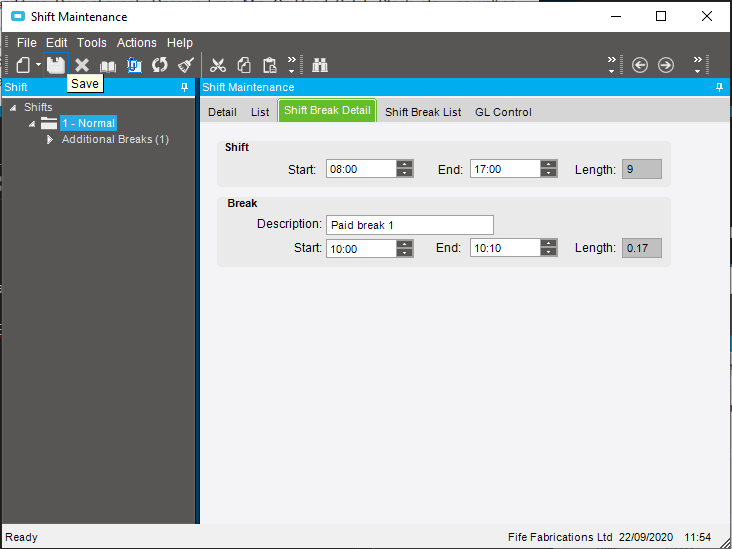

All Resources are set correctly against calendars.
All Materials are set correctly to Related Operation.
All Subcontract Operations have accurate Days Out.

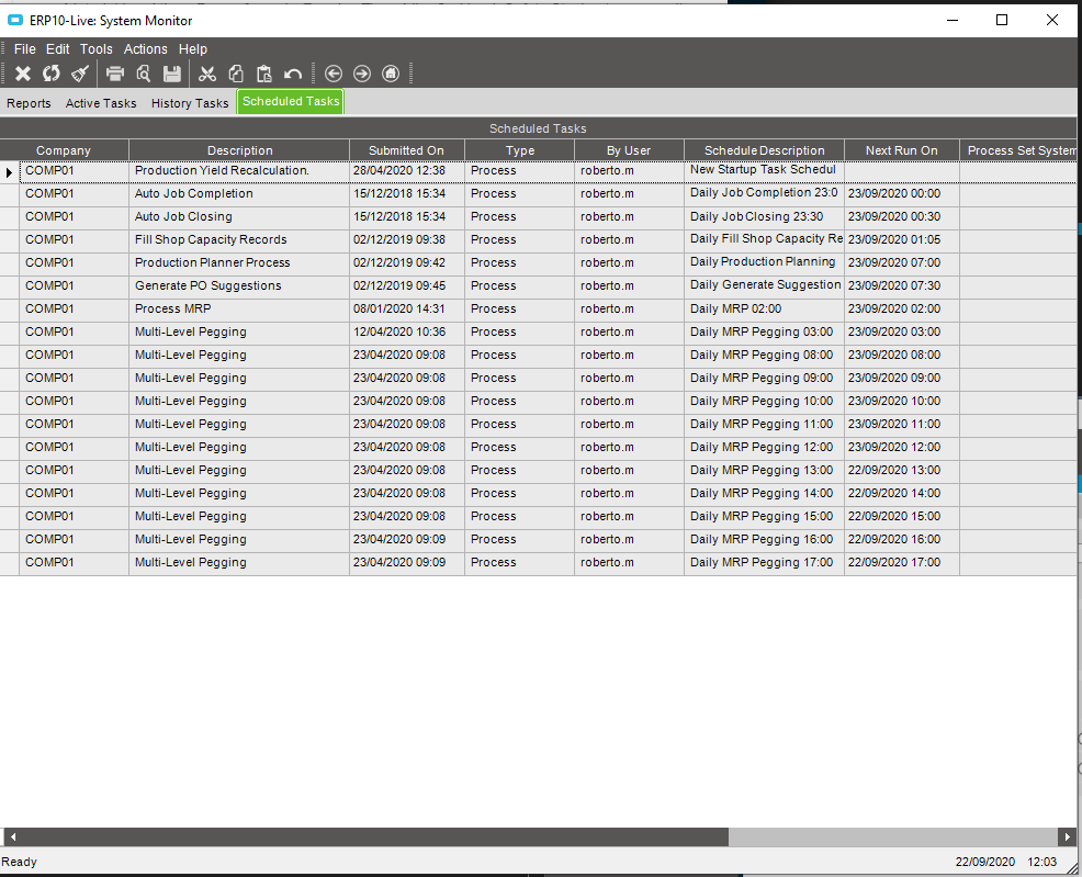

9. Scheduled Tasks:

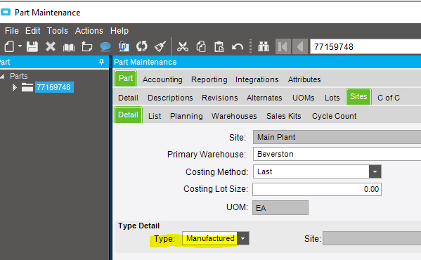

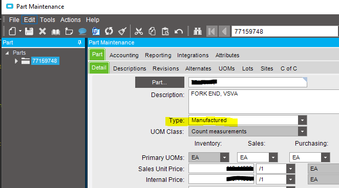

one more thing, check all Demand Sales Order/Line/Release for the part that you mentioned earlier, and make sure that all open and firmed, then run the MRP for just this part (has to be manufactured type as you know)

Demand is correct.
Sales Order is Open, Line is Open, Release is Open - Release is Firm.
MRP Run and no suggestion for Part - I expect a postpone suggestion from 07/10/2020 - 14/10/2020.
