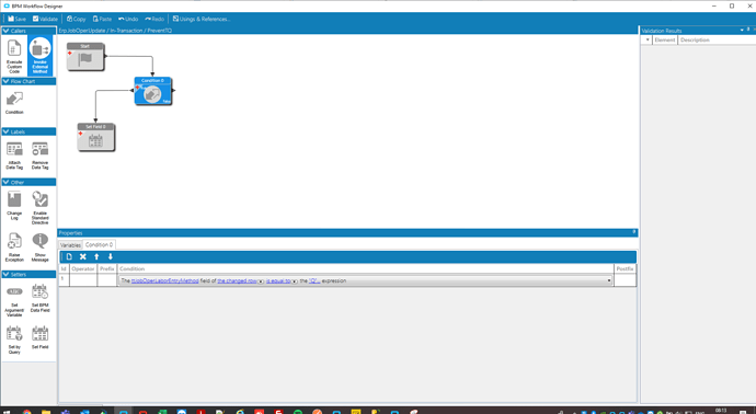

How would I go about adding LaborDtl to this bpm? or is it even possible what I’m trying to do.
I want to be able to adjust JobOper.LaborEntryMethod field based on if Quantity is entered and the field is set to T and should be Q then change it back after the Quantity is entered.
But I can’t for the life of me work how to pull in LaborDtl so I can look at this field.
Here is my current BPM (I’m new to it all)
Thank you
