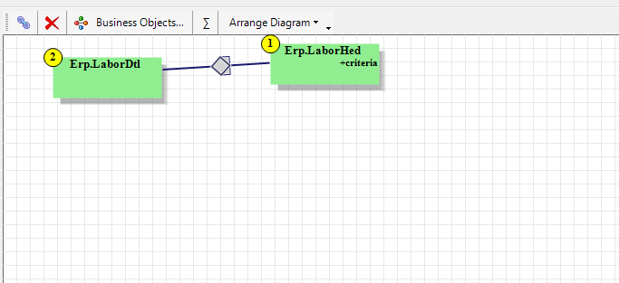

I have the basic BAQ setup but The trace and Data Dictionary viewer are new to me. Here is my BAQ. Can you tell if this is correct so far?
I am unsure if I have all the right fields that need to be updated.
Like @Banderson suggests, start with the Trace. It shows all of the business objects and their methods used as well as the datasets that are getting passed back and forth. Also, all of this is explained in the ICE Tools user guide. Live it. Love It. Learn it. :wink:
