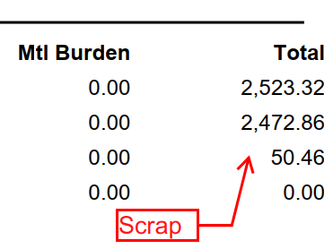

I ran the same job, the same way. I scrapped 2 in the QC operation, when it got done it failed to complete because 2 were in WIP.

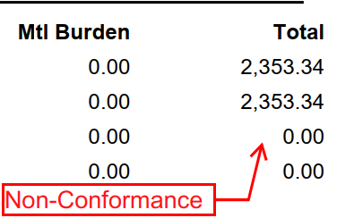

Non-conformance (from earlier test):
I ran the yield recalc, and it did change the qty to the 98 and the job completed. The 2 that were scrapped went to variance.
Scrap:
On the non conformance, the costs were removed with the DMR process, which is preferred by management. I guess our only choice is to start using the Yield recalc on our final operations.

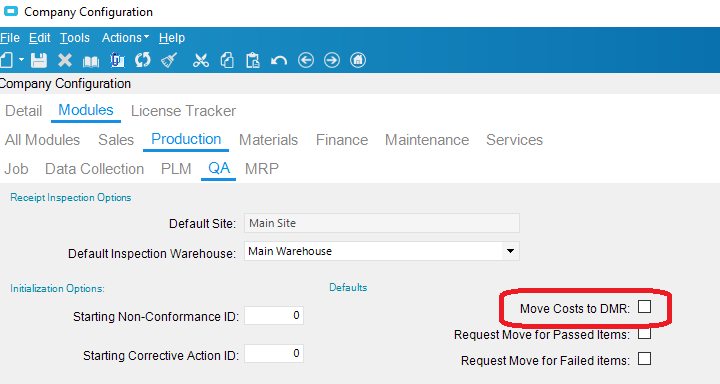

I’m getting to this conversation late… but have you checked the setting under Company Configuration > Modules > Production > QA > Move Costs to DMR?
