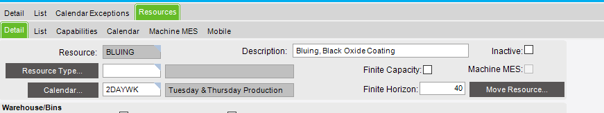

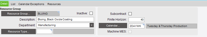

I have double checked the calendar that is attached to this resource and resource group. They all are the correct calendar. What is baffling me is it is only a handfull of jobs we have created not all jobs.
