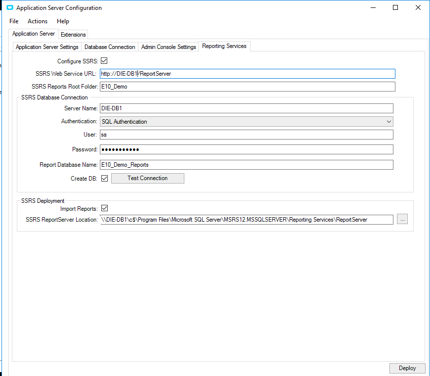

If you use an SQL account with SQL authentication in the Reporting Services tab settings it will fix the issue. I believe the issue is that the execution account for SSRS may be different than the account you are signed in as, so windows authentication is failing, but I’m not 100% sure on the cause.

What are you doing on the SSRS Tab in Admin Console? I assume when you click the database selection you get to pick an existing database or are you trying to create a new database? SQL Account or Windows Authentication?
We are picking existing database using windows authentication. The ‘test connection’ button on SSRS Tab says everything is ok. We have verified user by connecting to database directly. The user is set up as server admin and admin to the Epicor databases.
What are you picking for the SSRS Report Server Location, does your user have access to that path? Also the http url… if you navigate to the URL using IE, does that open and do you have right permissions there.
If you go to the URL does it work… since it says SOAP I am assuming its failing to configure the Shared DataSet on the SSRS URL.

FWIW - I recently had issues with a new install of 10.2.300 whenever SSRS was enabled.
Turned out to be two things.
  1. A rights issue when making temporary files.
    a. Logged into the App server as myself (ckrusen)
    b. Launched EAC as myself (ckrusen)
    c. Set the App Pool user to one that has admin rights and more importantly, whose password never expires. (say _ad_epicor)
During the deployment, an error was thrown when a process started by _ad_epicor tried to write a temporary file to c:\users\ckrusen\... and user _ad_epicor didn’t have rights to my user folder on the app server. I should have logged into the app server as the user that the App Pool uses.
  1. An error in the SSRS ReportServer Location field.
For some reason I had set it as //USDBS00375\c$\ProgramFiles...\ReportServer
That would mess up the rssrvpolicy.config file every time An app was deployed with SSRS enabled. That would break SSRS, requiring me to restore the .config file before SSRS would work again.
simply changing the URL to \\USDBS00375\c$\ProgramFiles...\ReportServer resolved that problem.
I’m surprised that a bad value in the SRS ReportServer Location field was able to do so much damage.

Next we will try with SQL Authentication instead of Windows Authentication but we ran into issues with that process too.
Using SQL Authentication worked but i ran into a different issue.

Hi, right click Admin Console and “Run as Administrator” option resolved this issue for me. hope this helps someone.
