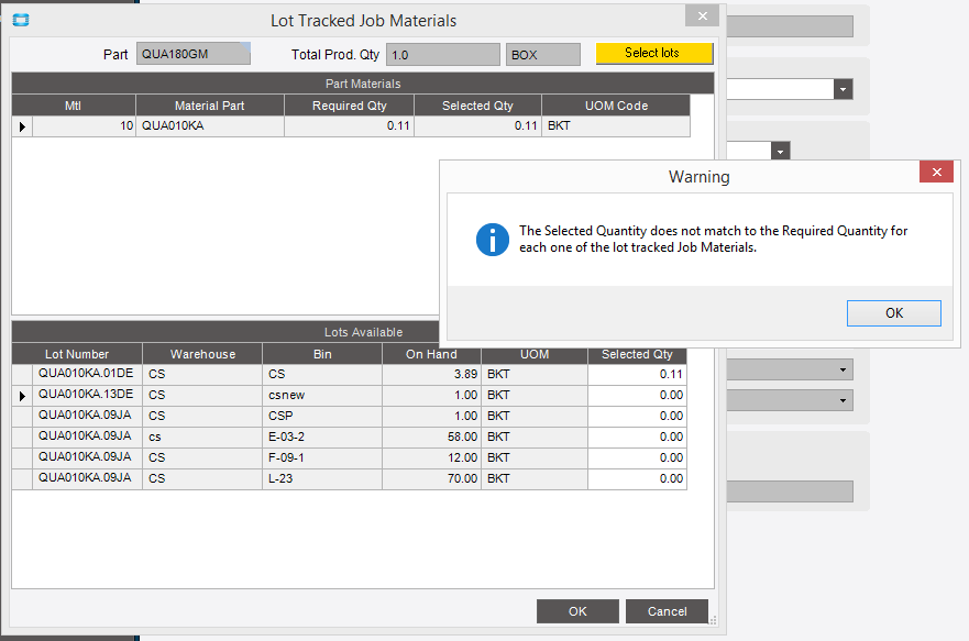

Yep - seems that way. I reported an issue with 10.1.400 whereby it would swear blind that the qty was off, but as you can see from the screenshot it wasn’t:
We’ve moved to proper jobs now away from Kanban Receipts, which has the advantage that you can over issue/ under issue as you please. Supplemented that with some screen mods/BPMs to enforce some business rules.
My case ref on 10.1.400.18 was CS0000194801 and PRB0181287 the problem record. It was corrected in later version of 10.1.400, but it might be somehow related?
