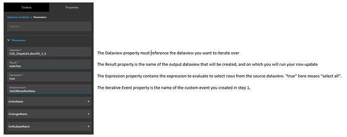

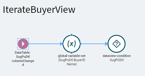

1- Write a custom event with no trigger (“User Defined Action”) that will do what you want done on each row (for example, your row-update)
2- In your button’s OnClick event, use the dataview-condition widget, like so:

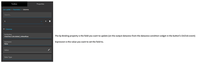

3- Your custom event’s row-update should look something like this:

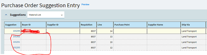

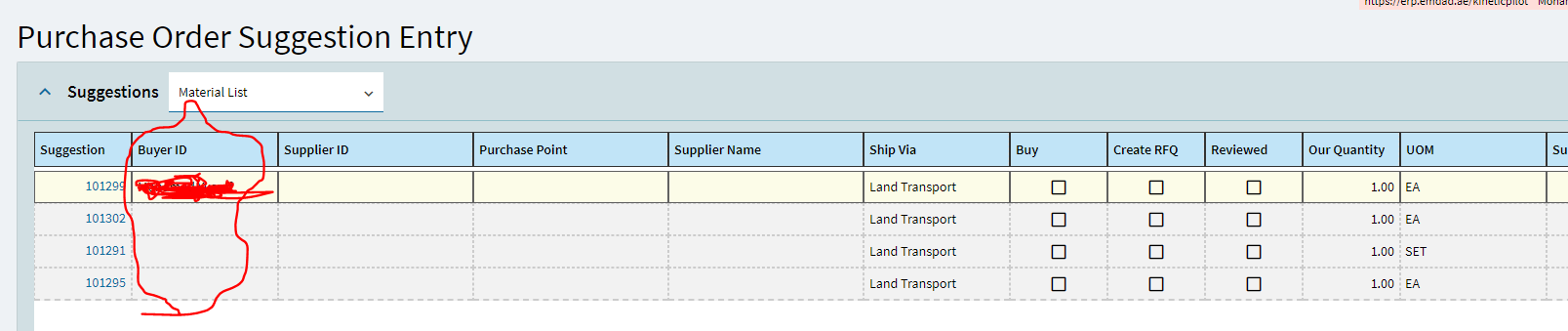

In New PO Suggestion screen , buyer will search & select the lines of same requisition no in the datagrid then they have to update their name one by one of the each selected rows. what I want to achieve is when the buyer update their name in the first selected rows automatically rest of the lines should get updated with the same buyer name.

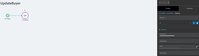

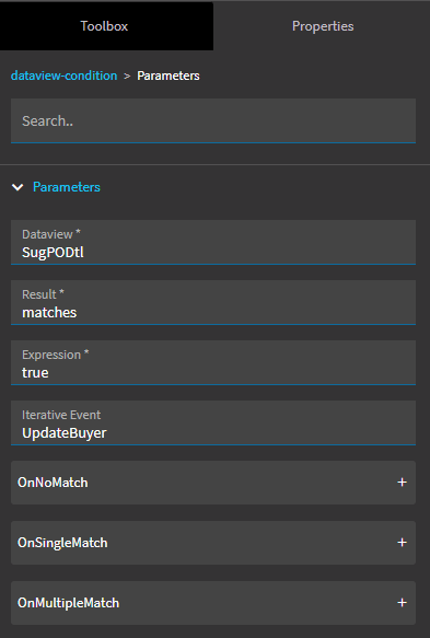

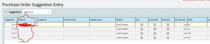

Thanks for the suggestion, I tried but the row is not updating

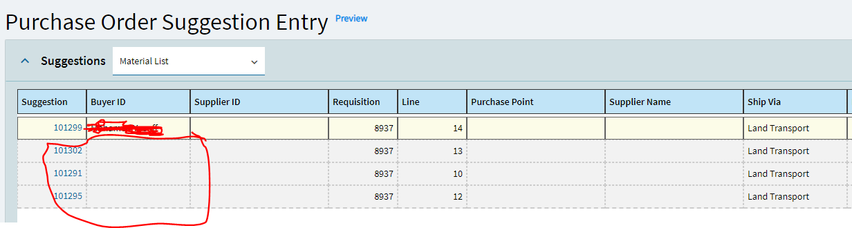

Output:-
The “O” is lowercase.
You’re also going to want to set your global variable to the buyerID, not the name, then set matches.BuyerID. The value of the combo is the ID–the name is only the display and will show according to the ID set.
