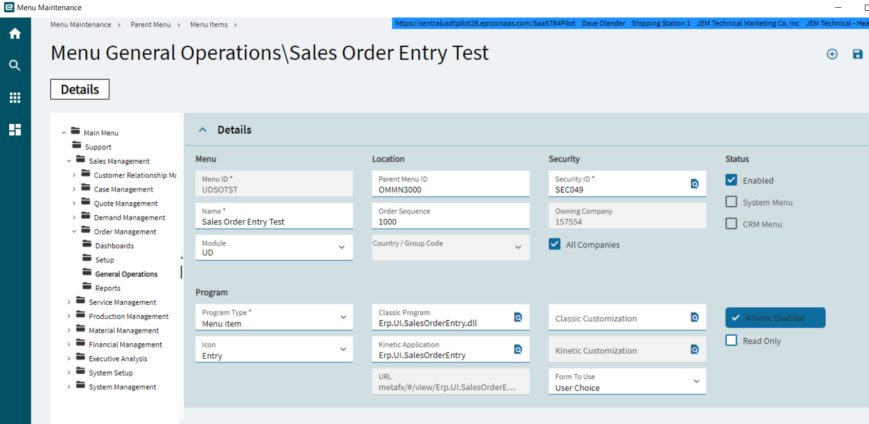

I am having trouble getting the “User Choice” banner to show up for Sales Order Entry.

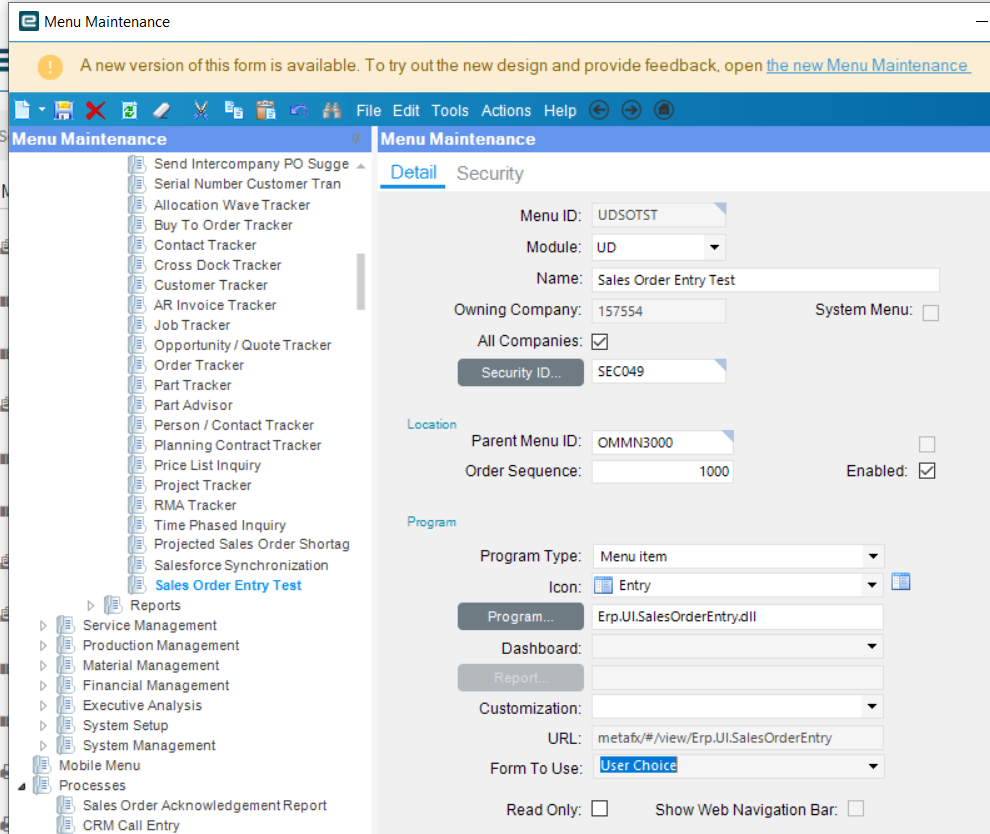

I did go into the Kinetic Menu Maintenance and set the Form to Use as “UserChoice” and My user is set as “UserChoice”. However when i open our Sales order entry - i only see our classic form.

The banner is based on Menu item arguments so even opening it in base might not work. Try deploying base to a menu item for kicks and open that see if you get it?
I tried adding a new menu item (No customization) and now when i open sales order entry I get Kinetic UI - No Classic (with option for Kinetic).

When i set my profile to “Classic” then i get the Kinetic Banner just for my Test Sales Order Entry.
The Customized version still only show Classic and no Banner.
I went back and changed My Profile setting to “UserChoice” and my Test Sales Order only comes up in Kinetic UI.
