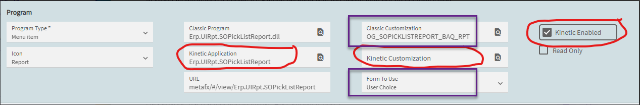

When trying to launch Sales Order Pick List Report from Kinetic Web menu item, getting error:

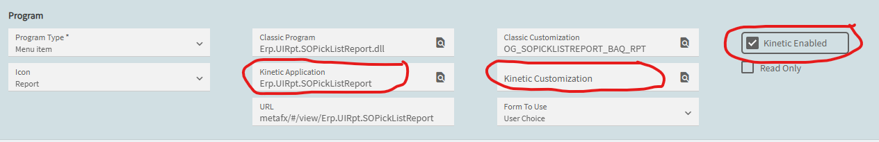

In Menu maintenance it shows it’s Kinetic enabled lists the application but no customization:

did you have a customization on that form?
not in Kinetic Web, but there is one in Classic UI
we were able to work around it by adding a new menu item and changed the program type to “Kinetic”
@datadaddy this is your issue.
Despite having “User Choice”, it will absolutely try to open that classic customization and you’ll get that access message.
Not really a “user choice” now is it? :sweat_smile:
menu maintenance has been a trip so far from 2021 to 2023.
I guess it’s a bit more nuanced than that.
What I found to work was setting the menu to User choice and setting each client to be “Classic” (this can be done with the dashboard I posted around here somewhere), then when they open a screen in the client, it should open the classic only. When they open it in the web browser, it should open Kinetic.
I only tested this with dual customizations (classic and kinetic customization set on the same menu), so I’m not sure how it will react if there’s no kinetic layer and you try and open that screen in the web.
This also won’t be a great solution if you use the shudder embedded browser.
