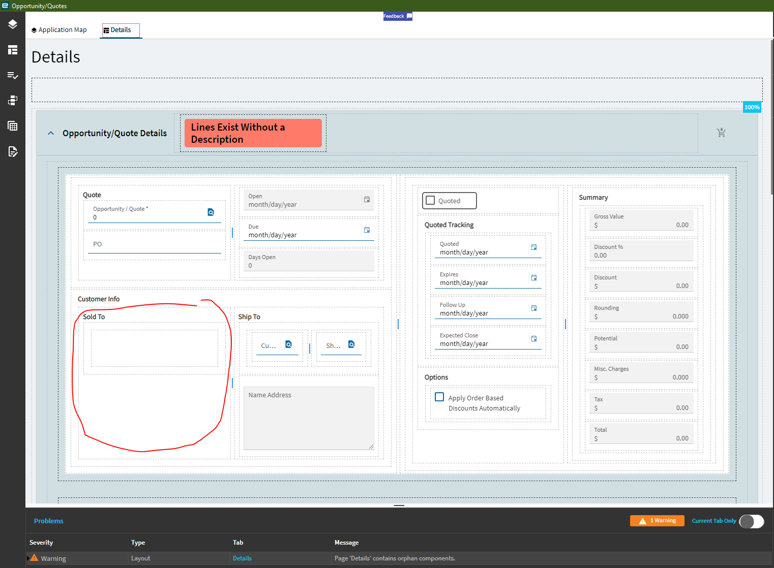

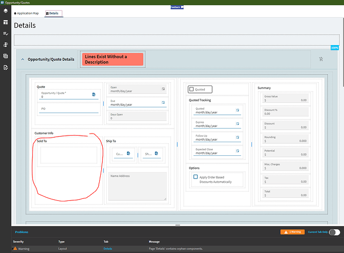

But, what I wasn’t expecting, is that even some BASE fields were missing from some customization layers… which made them not appear in the resulting form load. Below is one example:
This is the Quote Entry form. I have (3) customized layers.
  • Order Head customizations
  • Order Line customizations
  • and a “Hidden” layer… which just hides unwanted fields that our company doesn’t use.
The missing “Base” fields exist in the “Hidden” customization layer… but don’t exist in the other two.
So, I guess my question is… what is the best approach for correcting this. Should I manually add these Base fields back into my customized layers? Should I wait and see if Epicor fixes this (not sure why Base fields would exist in one of my customized layers, but not the other 2… so I’m not sure if Epicor would consider this a bug or not)?
I could attempt to “Merge” my customized layers… but I’ve never attempted this and I’m unsure how that works. Which layer takes precedence, etc.
Missing the “Sold To” customer information on Quote Entry is pretty important though… so I’mma need to do something.

We’ve had the exact same issue as you on the Quote Entry screen.
Missing ‘Customer’ and ‘Sold to’/‘Ship to’ fields on the Quote Header tab.
Also missing 90% of the fields on the Quote Line Worksheet tab.
We’d made customisations (layout changes) to these tabs but hadn’t touched the above fields specifically.

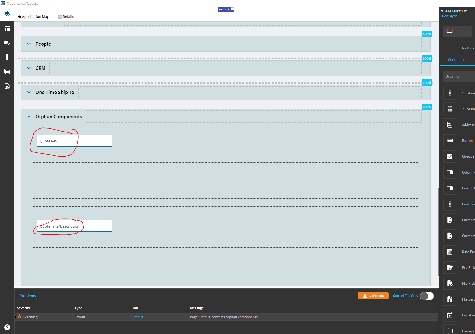

An interesting observation this morning, which may or may not have been there previously and perhaps I just didn’t see it.
Some of my missing fields (UD fields) are missing from Quote Entry. I had added a “Quote Revision” field and a “Quote Title” field.
When I go into App Studio, I noticed there was a “warning” that there were “orphaned components”.
If I go to the Details tab (which is where I had them installed) and scroll to the bottom of the page… indeed my two missing fields are there.
What’s odd, however, is this “warning” and “orphaned components” are only visible when I first open App Studio and am looking at the “base layer”.
If I load the customized layer where the fields were actually created… there is NO warning, and the “orphaned components” are not visible. So, here again, if I wanted to put them back into the layer in which they were initially created, I would have to re-create them… even though they exist on the base layer (just moved to the bottom of the form because they were “orphaned”).
In either case… the Epicor Base fields for Sold-To Customer and Bill-To information are still missing. But I was surprised to actually see my missing UD Fields… albeit on the base layer and not my customized layer.
