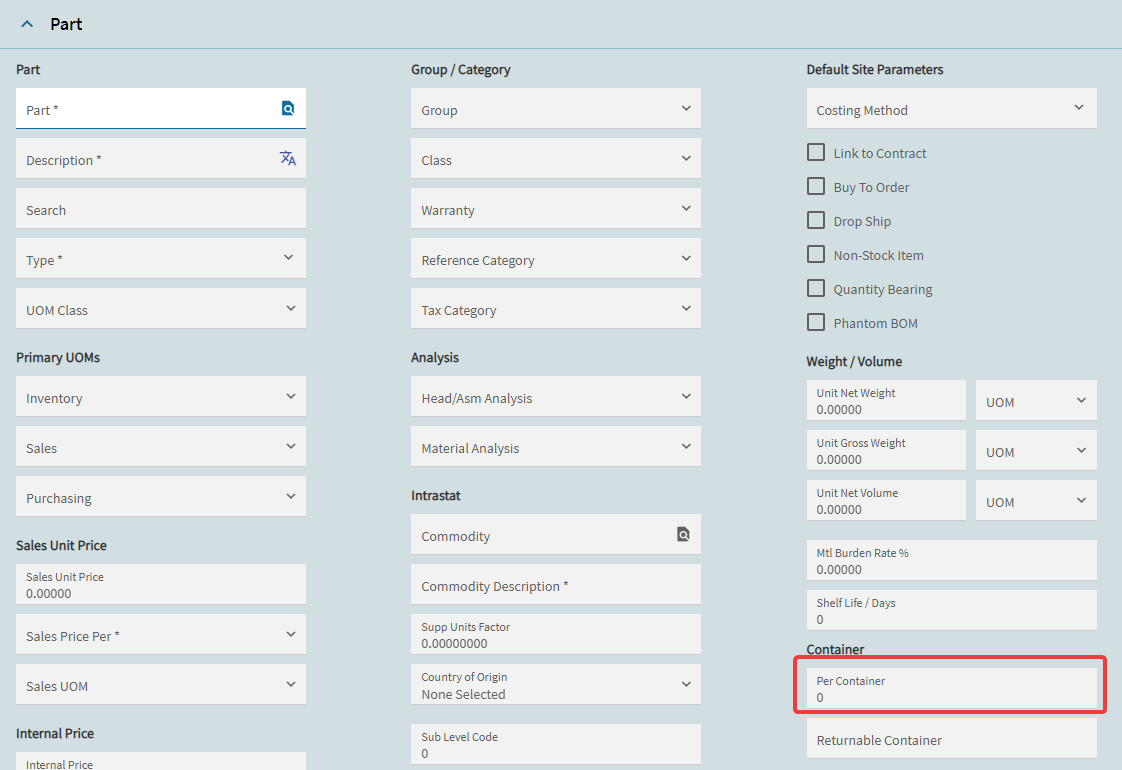

Per Container Field on Part Master Missing in Kinetic
Does anyone know where the per container field on the part master is on the Kinetic screens?

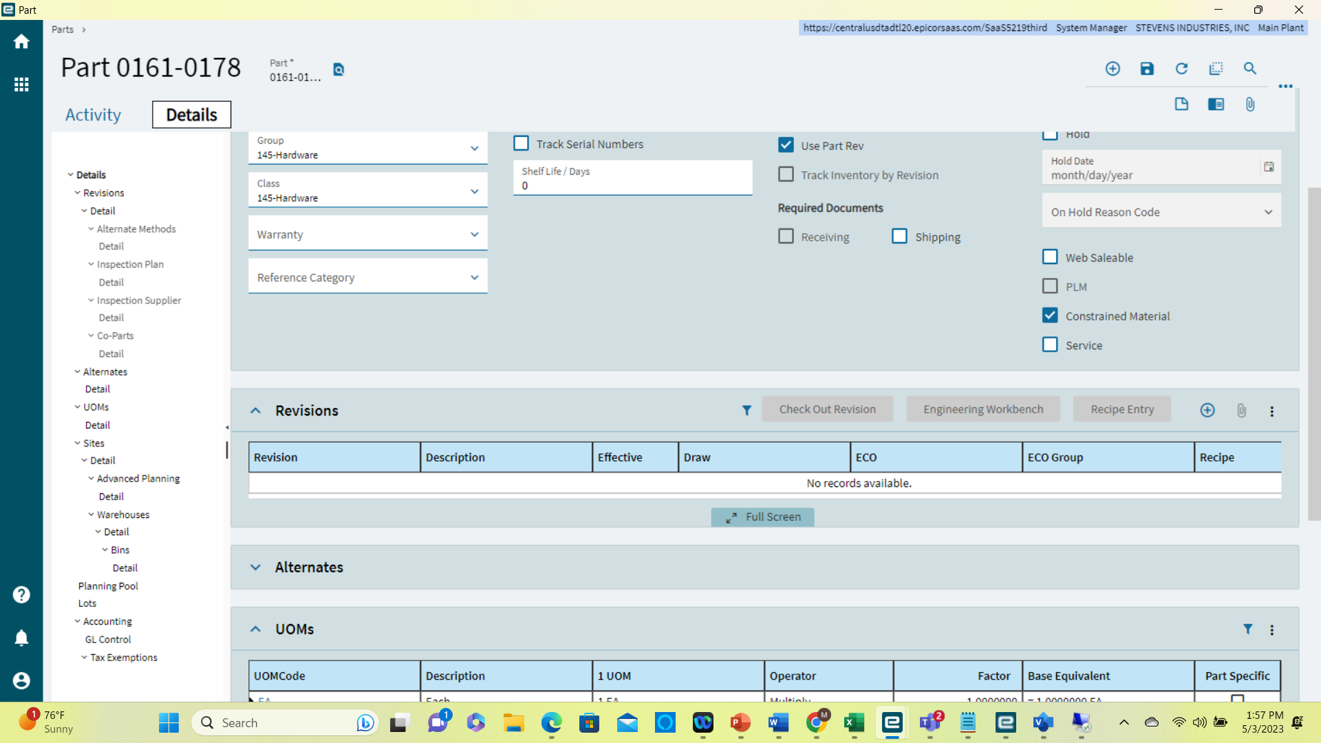

Here is what I am seeing as of the latest update by Epicor for cloud customers
I know they were working on re-arranging the screens to group the fields more logically. There is a scrollbar on the right, maybe you need to scroll down farther?
If you scroll it just takes you to the other cards below. It looks like they are missing fields. I don’t see unit price as another example

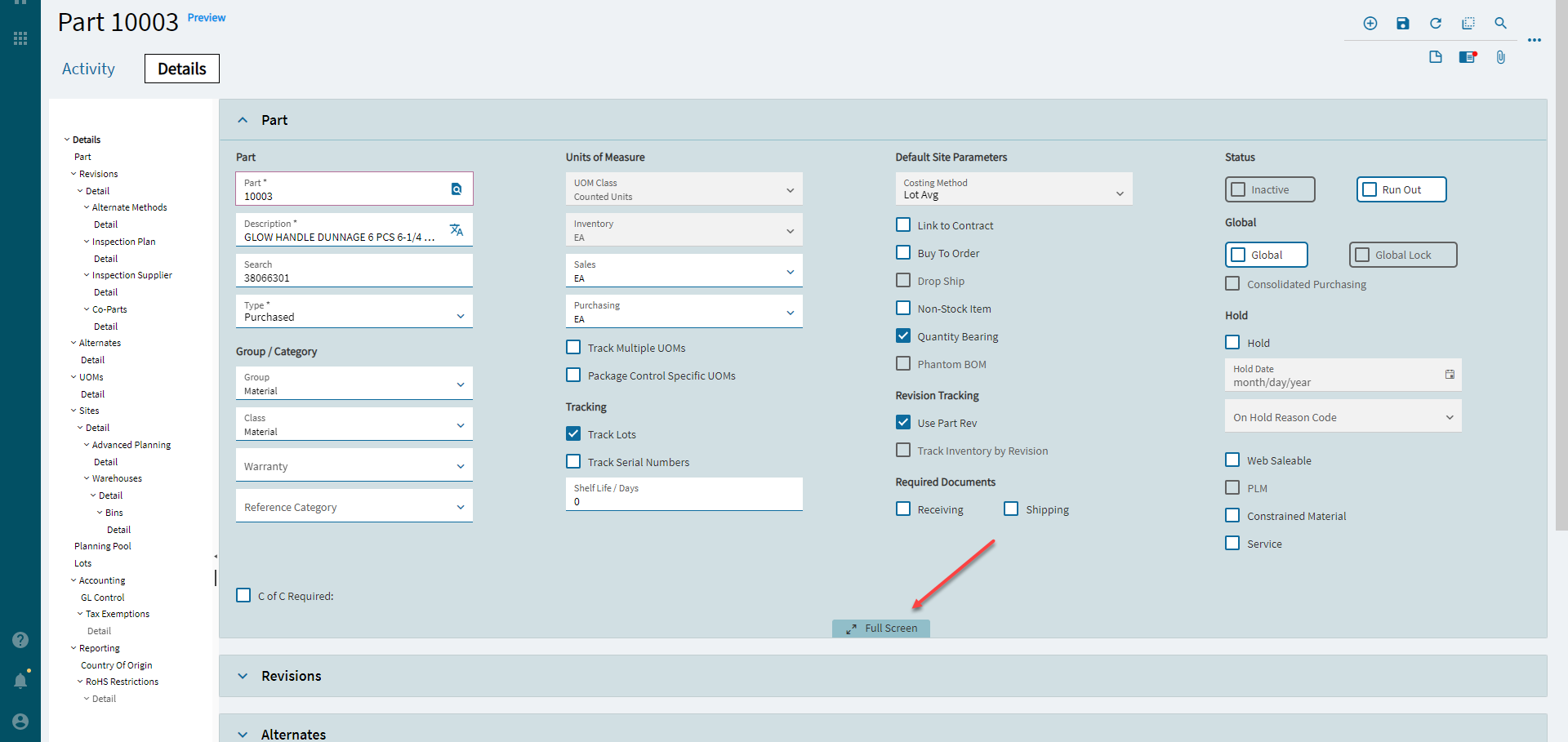

A better question to ask would be “Where is my full screen button?” because it’s in there.

Yep sure is! Wonder if they know it is missing. I’ve checked 3 different companies who are on cloud and all of them are missing that button based on the last update

@timshuwy, based on their screenshot, it looks to be at the bottom of the first card already.
Full screen should be right here for that card (you can see the one for Revision below, though):

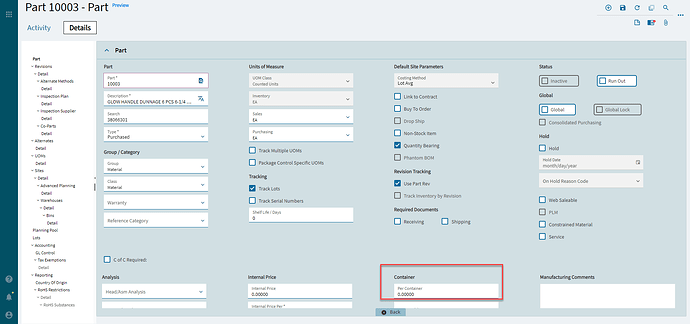

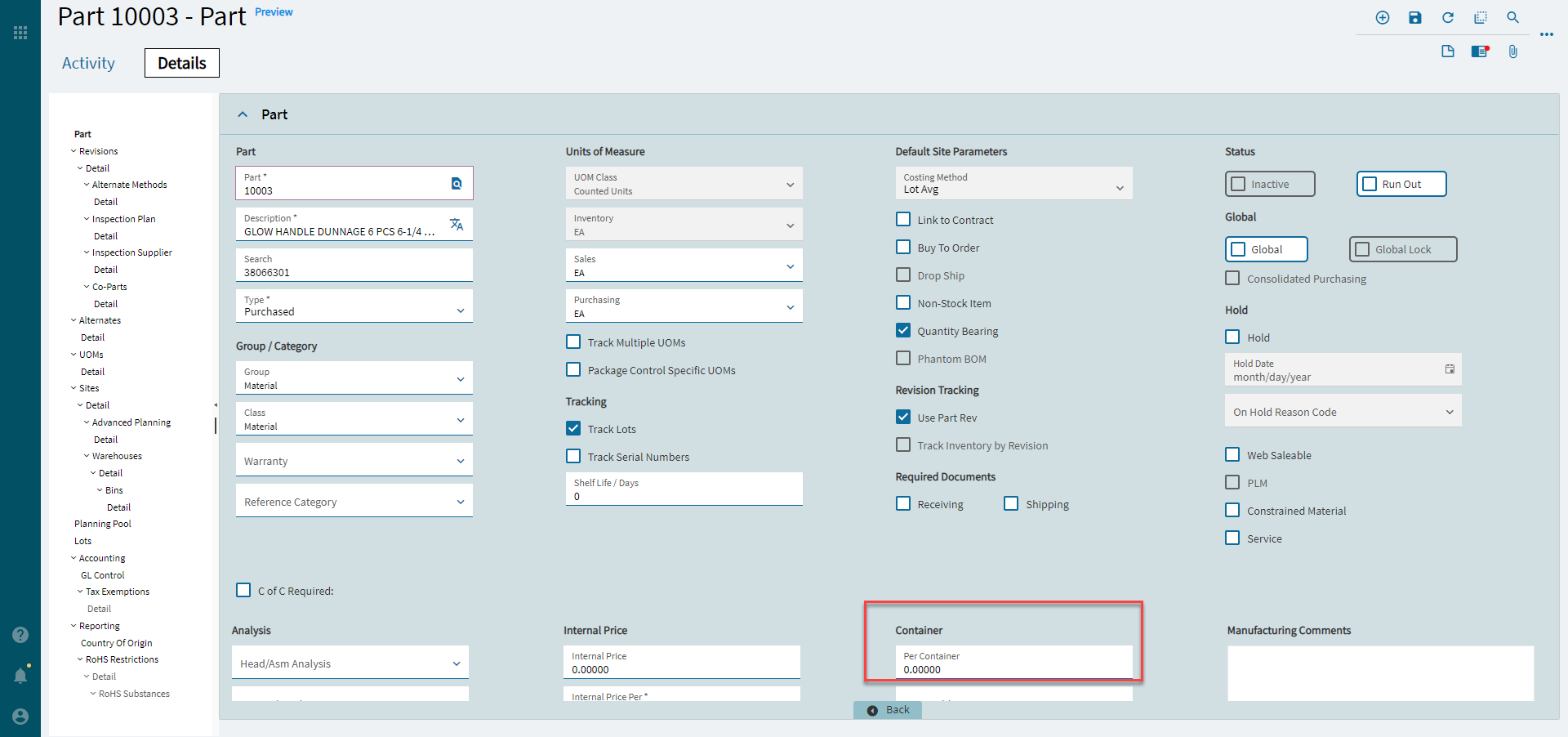

Maybe, Maybe not. My 2023.1 works correctly in the browser and smart client on this screen.
Intermittent issues?
Mine works. I’m out. :v:t2: :sweat_smile:

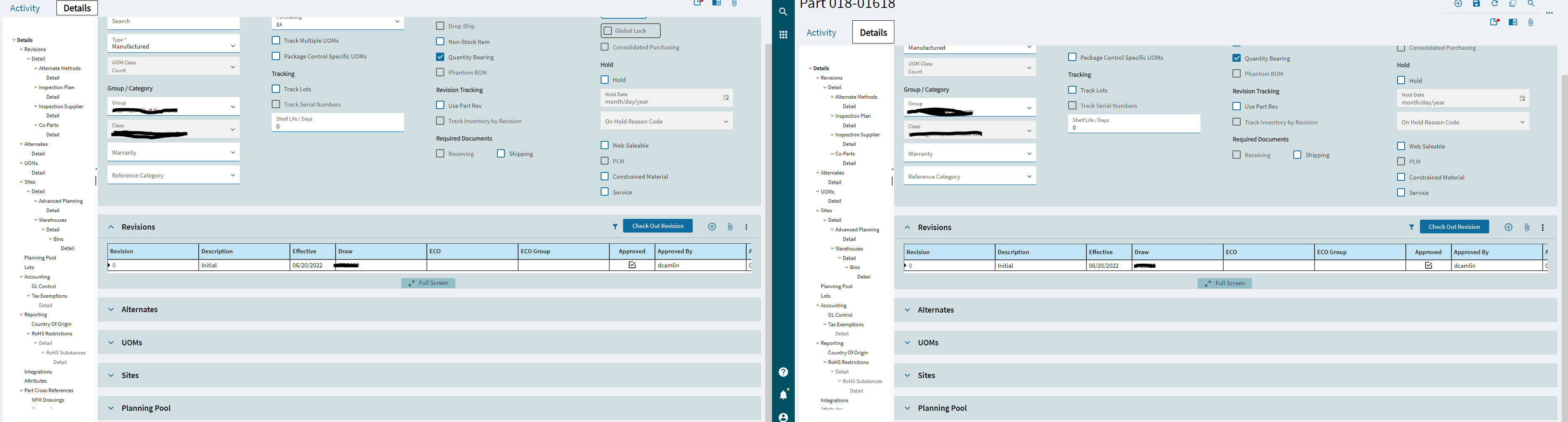

Client on the LEFT, Browser on the RIGHT… “Full Screen” is not an option on either.
