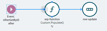

Thanks everyone for the help - I am calling a function on the Time Entry to do some calculations on the RunQty and returning the value (called from a new event (AfterGetById). That’s working fine but still haven’t figured out to get the row-update to set the value of the new field.
I’m using an Epicor function.

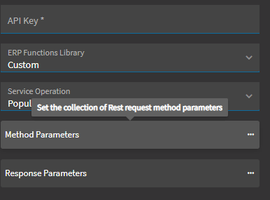

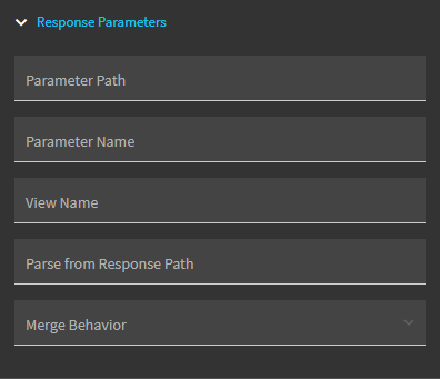

No response parameters defined on the erp-function widget yet. What should I add to this and the row-update?
Thanks everyone :slight_smile:
Run your function in Swagger, Postman, etc and post the response JSON. You need that to fill out the response parameter properly. More than likely, it’ll be returnObj for the “Parse from Response Path”, but not always.

Thanks … final question I hope :slight_smile: what am I doing wrong here ?
Getting Non-static method requires a target error
Event
Function call
Row update (bound to column on Dataview)

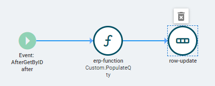

I can show the result via dialog box
{action.message}
But when I try to change the field in the row - it just doesnt happen.
I can chose the view and the field but when I set the expression to {action.message} nothing happens.
I am displaying this value via dialog box - it has a value
