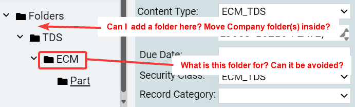

Hello,
I’m just getting started setting up ECM as a repository for our attachments in Epicor Kinetic. I am wondering if there is a way to tell ECM or Kinetic what the base folder structure should be. Currently it automatically creates a folder at the “top-level” in ECM, using the Kinetic Company ID.
Is it possible to put these Company folders one level deeper, maybe in a subfolder called Kinetic, for example?
Also, it is creating an ECM subfolder inside the Company folder. Seems redundant, considering we are in ECM. Can that be prevented? Is there a reason for it? Are there other folders that could exist at that level of folder structure?
You can move the folders and documents however you want - it’s up to you to make sure the documents are in the right place and proeprly secured.
But these are great questions - but you’ll find there are two camps on this topic.
Folders are useless - the index and search feature are your friends. If each document is properly indexed, named, and attached back to Epicor transactions, there will be no need to traverse the folder structure looking for your documents.
Humans use the system - As long as humans get into ECM directly to work with documents, some level of folder structure is nice.
But I’ll say that there is a nice location in between. And it has to do more with Security Class (and folder security) than anything else. We created a content-type folder under each company folder, and all of our workflows have a specific step where the naming, moving, and setting of security class is done before the document can proceed in the workflow. this allows us to use ECM for many more things than Kinetic attachments and maintain a consistency for users of both Kientic and ECM.
Getting past any philosophical discussion on the merits of document management systems, you will use the system as you choose and anything that works for you is a perfectly good answer.
