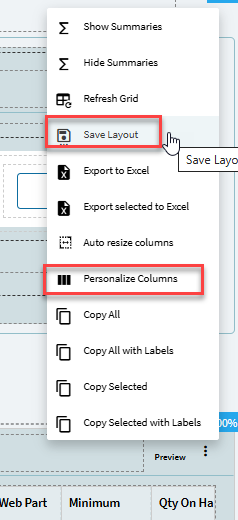

4: I use Personalize columns to show/hide and arrange columns. Then size in the grid and use Save Layout

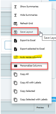

  1. I also use Personalize Columns to show/hide and order columns. I don’t usually take the time to set column widths though. The Auto Resize Columns option in the overflow menu is nice. It doesn’t seem to work for setting a default in App Studio; however, your users can quickly resize all columns at once in the dashboard. Just beware if you have a large text field–you’ll have to shrink it after or remove it first.
Agreed, I’ve showed the auto-resize to our users as the widths I set aren’t always what the user wants.
