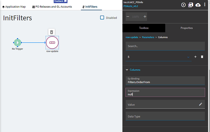

So, I can do this - to null out the field - this works fine.
But how would you initialize it to today’s date, for example? (Dynamically)
@mbayley @tpogue You’re the filter-initializing gurus, right?

Set the expression as '{Constant.Today}'

YES!!!
This worked perfectly! Thank you!
Now the users will not automatically run the report for all time.
