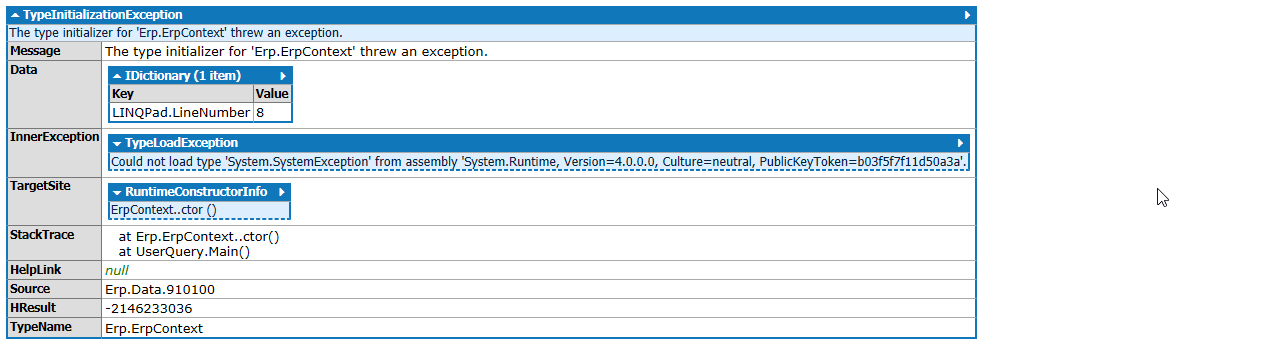

Kinetic LinqPad Starter
I used to use the following to connect to E10, but since switching to Kinetic, this no longer works and I get the error about not finding System.Transactions.Local
Does anyone have a way to connect using LinqPad?

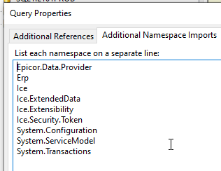

and additional namespace imports

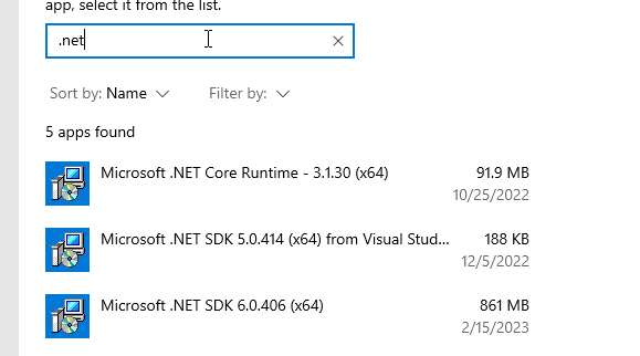

First step is to install .NET 6 SDK, and see if that fixes it.
I installed .net sdk 6.0.406, rebooted and it’s still not working:

I’ve added System.Transactions.Local and still get this error:
That one is in “System.Runtime.dll”

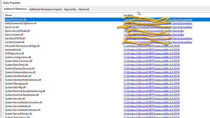

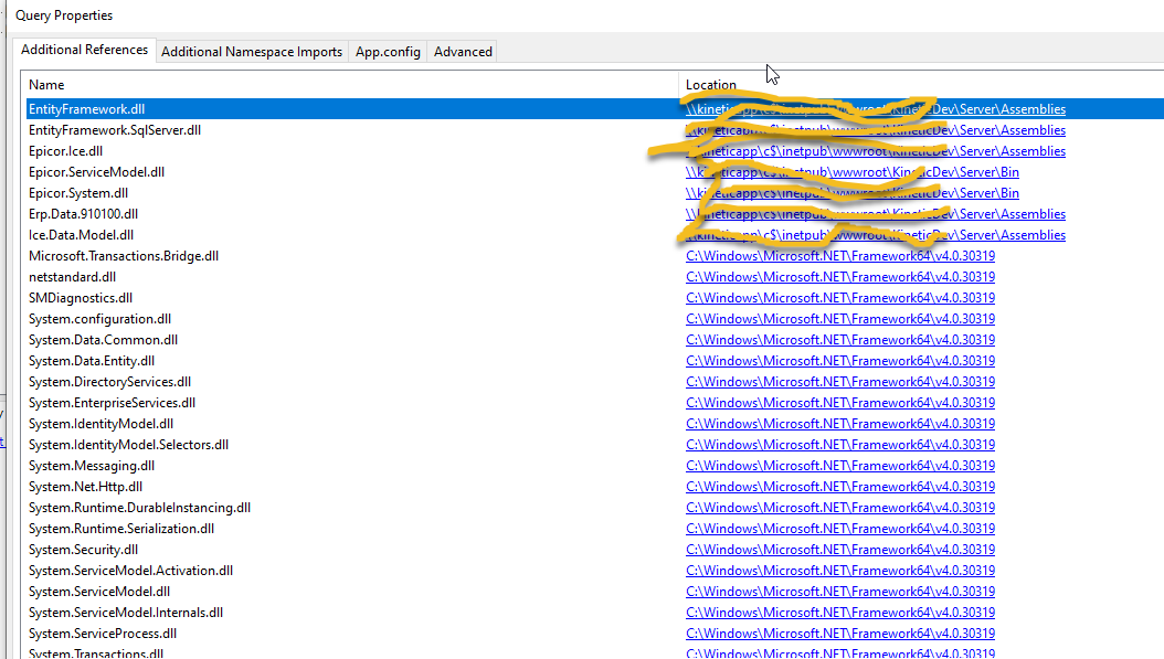

I just now seen this picture. All the .NET references you show there are
.NET Framework 4, not .NET 6.

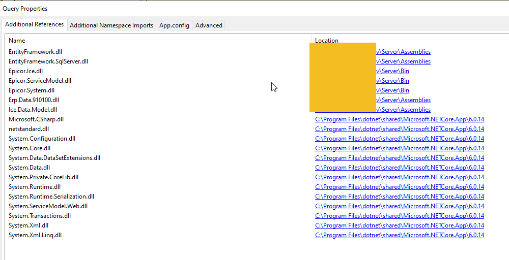

Try referencing the 6 versions, and if you don’t need it all, pair it down to the
bare minimum for troubleshooting.

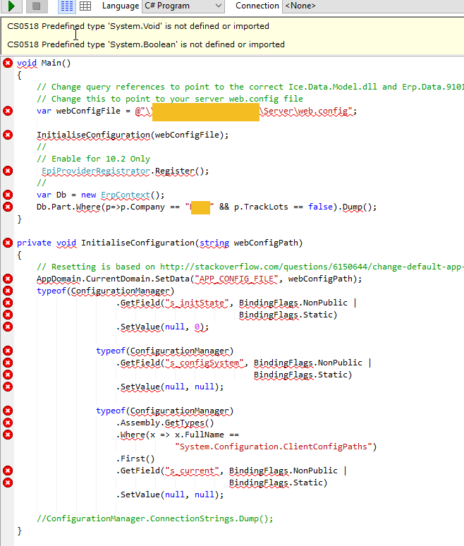

I switched them all to .net 6, still getting errors.
here is a screen shot of the errors:
i did not try .NET 6 server with linqpad, but just from looking on the screen I can tell, that you will have to rewrite this.
