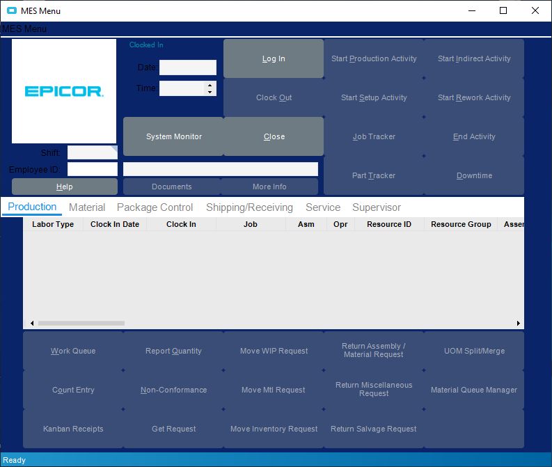

/MESC is not working as per usual for customization of MES environment, do you know if MES customization has been removed?
I do know that we are not yet able to customize the Kinetic screens but it is coming - just not sure when.

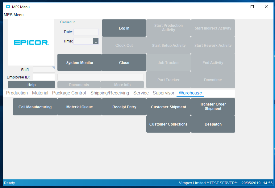

@Alphanu Are you saying that the Kinetic MES screen uses your regular customization for the base MES screen? Can you elaborate if anything special needed to be done?

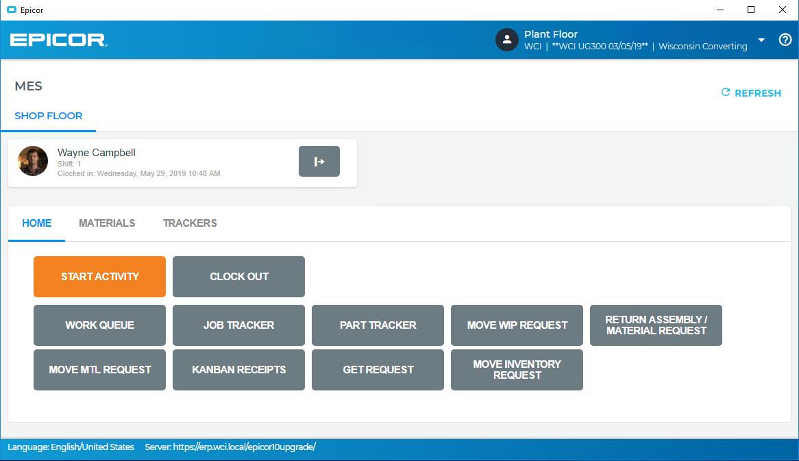

@Alphanu you have applied the Kinetic Like theme to the regular MES. But that is not the new Kinetic MES (available in 400)
The new Kinetic MES looks like this and is not customizable since it is written using the new Kinetic Framework (Angular) and Epicor hasn’t even finished internally with the customization engine for this interface.
Right - thanks Jose - got so excited that I didn’t really ‘see’ that the screen wasn’t the Kinetic screen. I am impatiently awaiting this to use in our deployment…
Ah I see, so kenetic is not the default MES dashboard then. My bad.
