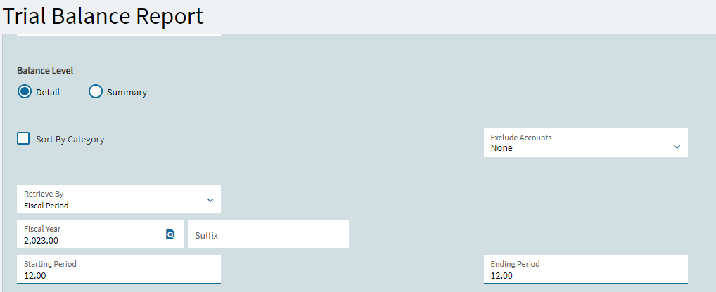

I’m seriously at the end of my rope. I am trying to run a Trial Balance report, including ALL accounts. It is not including the accounts with a zero balance (or zero activity). I’m not sure what happened or how to fix this. Any thoughts?
ETA: The report is picking up about 10% of the accounts with a zero balance and zero activity. All of the accounts are “active”. I’ve run the Rebuild GL. I’m working in PILOT as the client is not yet live.

I have reached out to a few friends and they are also seeing the same results - the accounts with 0 activity and 0 balances are not appearing on the TB. However, it is very random - some accounts will be on the TB but most will not.

See above link from @aosemwengie1 . Per the KB article if an account has never had activity, it will not appear. Unsure if that’s what’s happening in your case.
Thank you. I wasn’t sure if anything had changed since then. Some of my accounts are appearing without activity and some aren’t. It’s not consistent, which is odd. I found a workaround for my issue.
