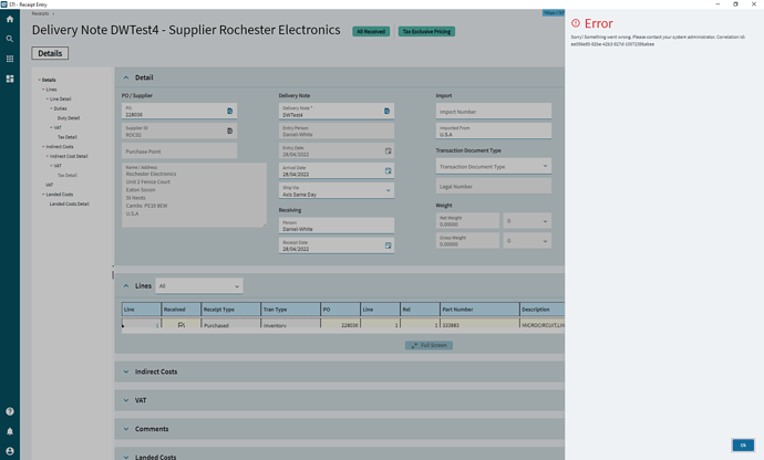

When i create a new receipt, i was expecting it to load the details from the PO Detail view i had created into the Receipt Detail screen (Manufacturer and MFG Part Num) but it isn’t and i just get the below error

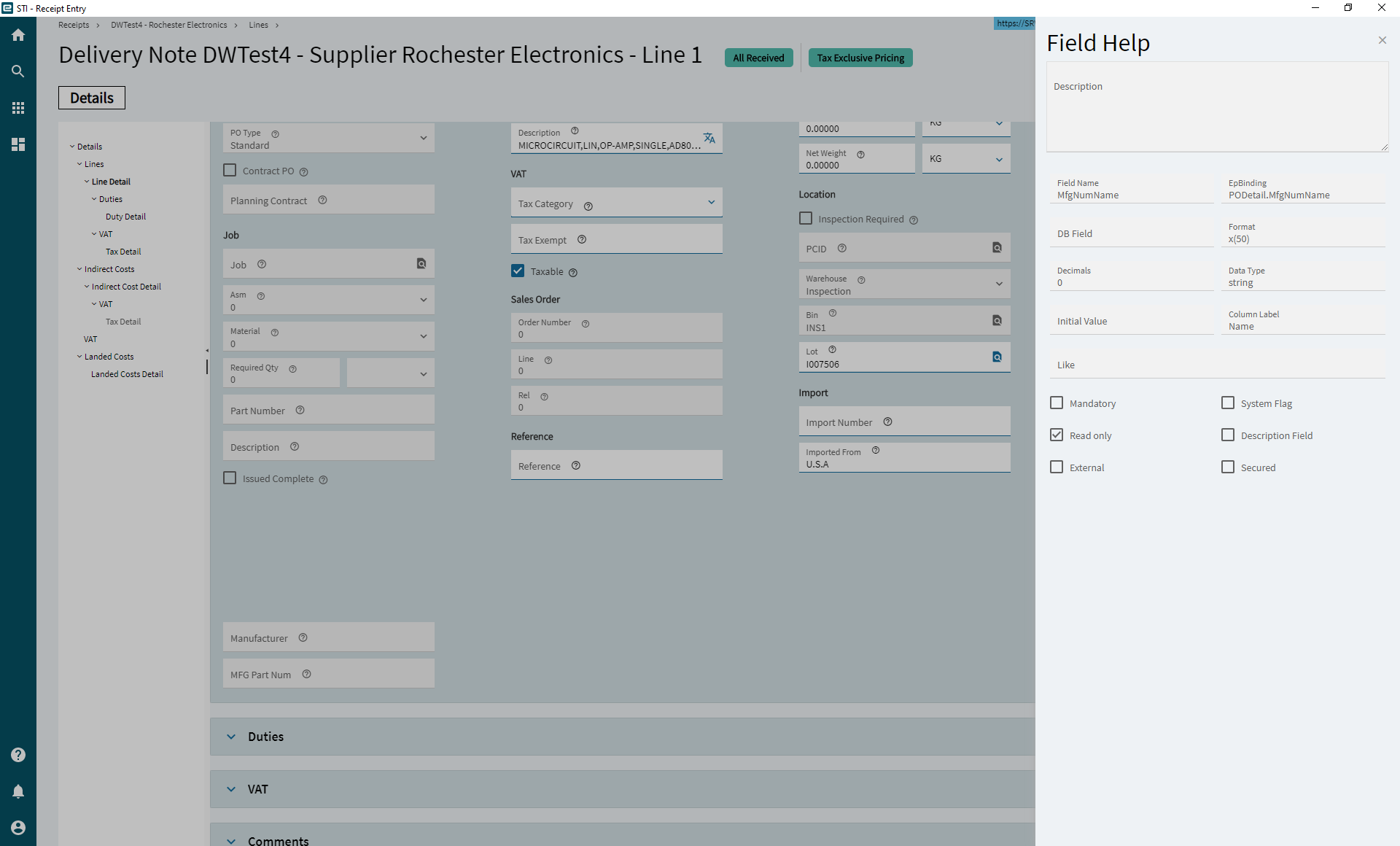

The two fields i created seem to point to the binding field but there is nothing displayed

If you open the browser dev tools you should see an error in the network call. You will probably find the event that was created (converted) to get the data has incorrect parameters. You can correct the event parameters use /api/help to see the correct parameters or use a Baq to pull back the data you need. There is documenation is the help that shows this approach for a BAQ data view.
