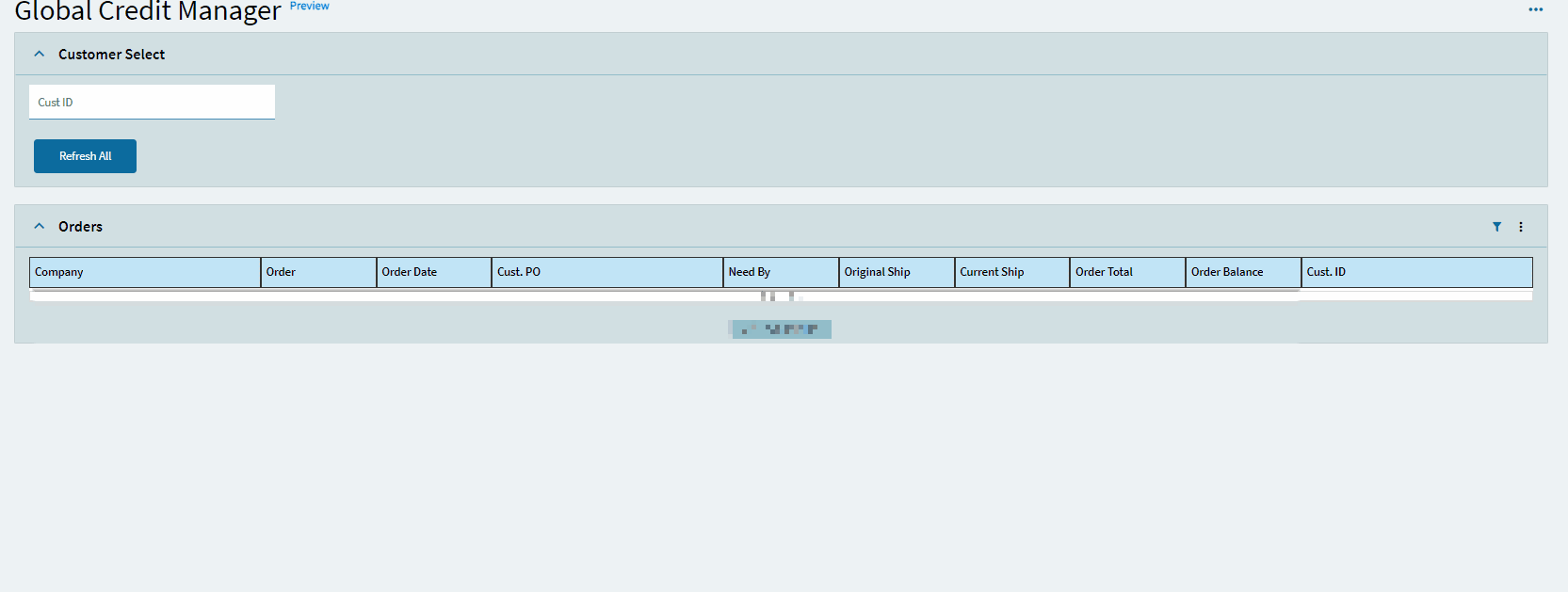

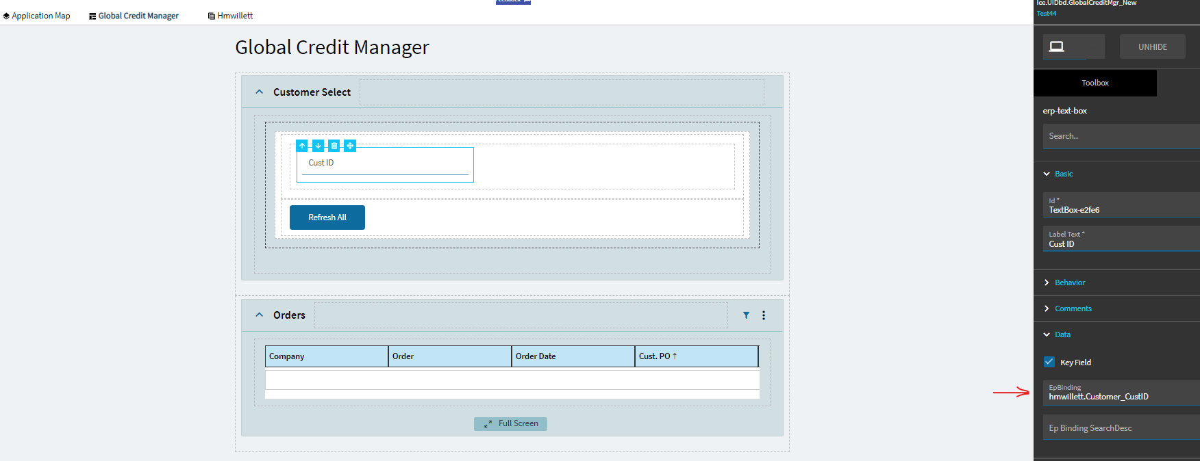

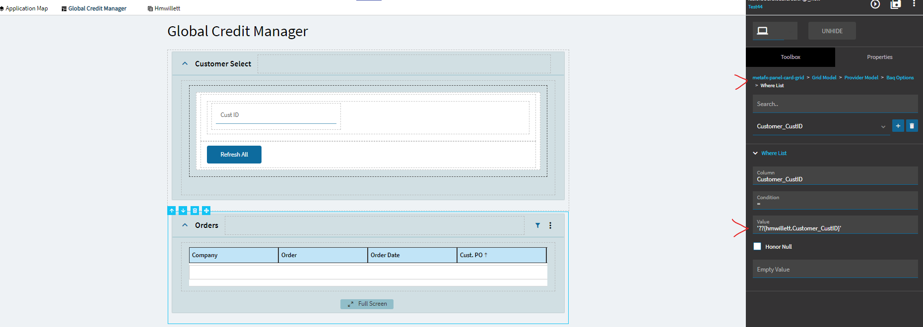

I’m trying to convert a classic dashboard for the first time, and as usual I am missing something simple. At the moment I’m just trying to successfully filter a grid by a user-entered Customer ID.
Does this look right? WHY WON’T YOU FILTER
kineticdash

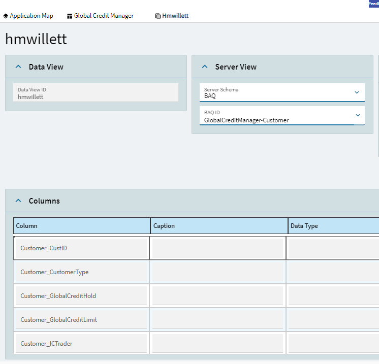

Uncheck the ‘Key Field’ indicator and initialize that field using an event after form load.
But also… Why am I your dataview? :thinking:
