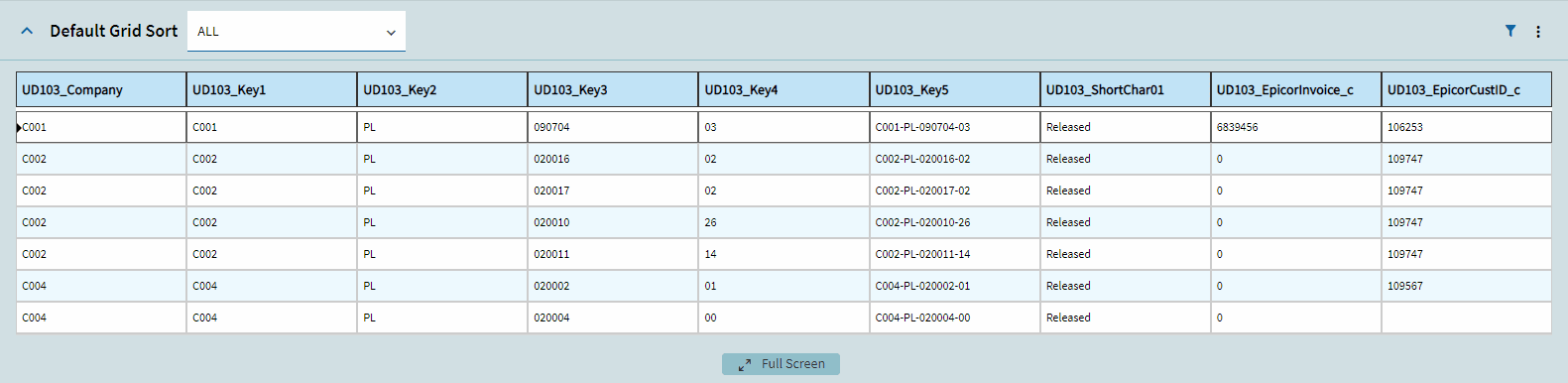

In a UD form I’d like to sort a grid by columns other than the keys. Anyone applied filters or sorts to a dataview in Kinetic?

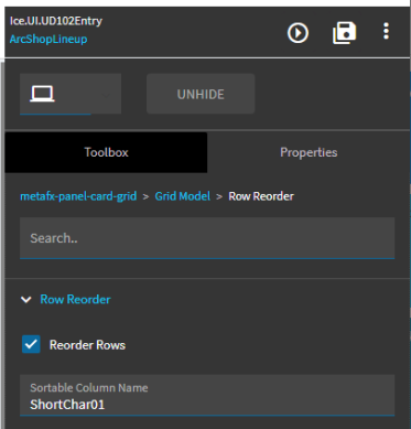

I added a column for ShortChar01 to the grid and added the sortable column name here, but it doesn’t seem to do anything.
Maybe this function isn’t functional yet? Maybe I’m leaving out something? Helpful hints?

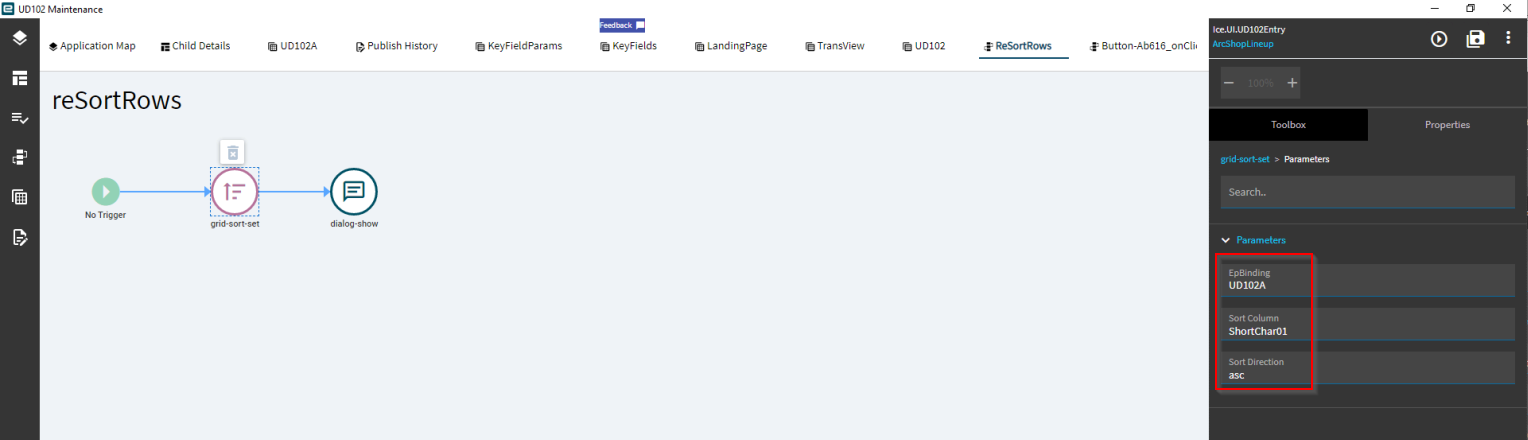

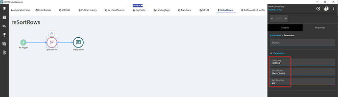

And here’s this thing. I’m firing the event from a button and I get the dialog screen that says it ran. But the rows in the grid don’t change their order.
It looks like I have the parameters set correctly.

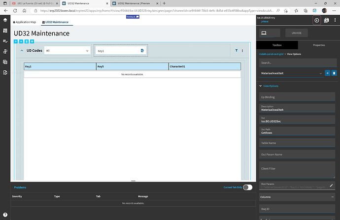

Joe, you should be able to create a View and set that as default. I’ll dig some stuff up.

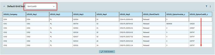

Okay–View in action.

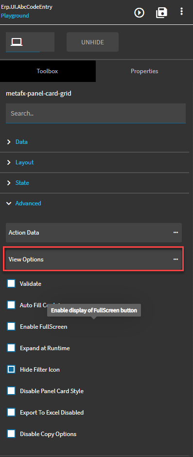

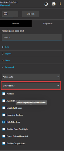

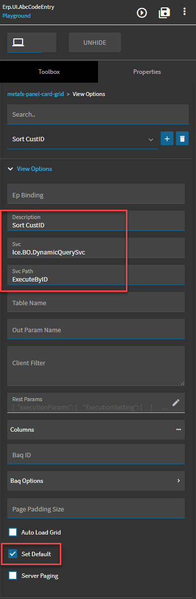

Go to Advanced > View Options
Give it a description, set the Svc to the appropriate service (I just used a BAQ for mine, but you can probably use a direct BO call to the table).
Mark “Set Default”.
Fill out the rest params as follows (you may need to review the Network tab of Dev Tools to find the execution settings for a BO table call):
	"executionParams": {
		"ExecutionSetting": [
				"Name": "Select",
				"Value": "DISTINCT *"
				"Name": "OrderBy",
				"Value": "UD103_EpicorCustID_c"
	"queryID": "UD103"
Then you should have some magic.

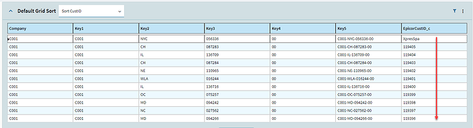

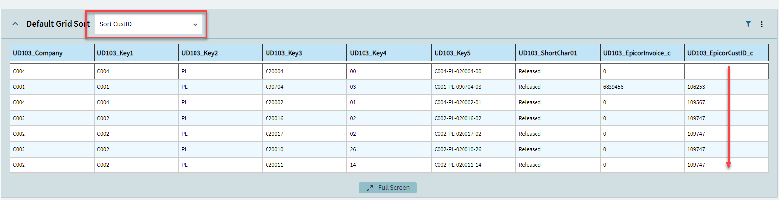

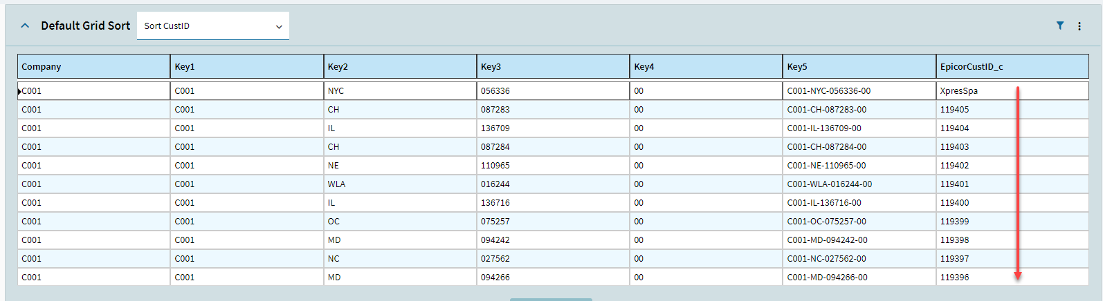

View

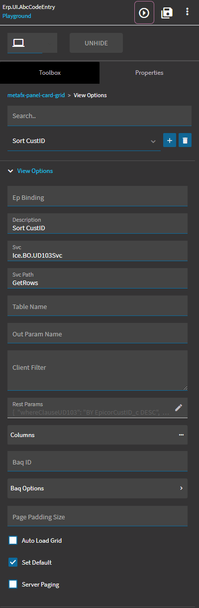

Slightly different for the BO calls.

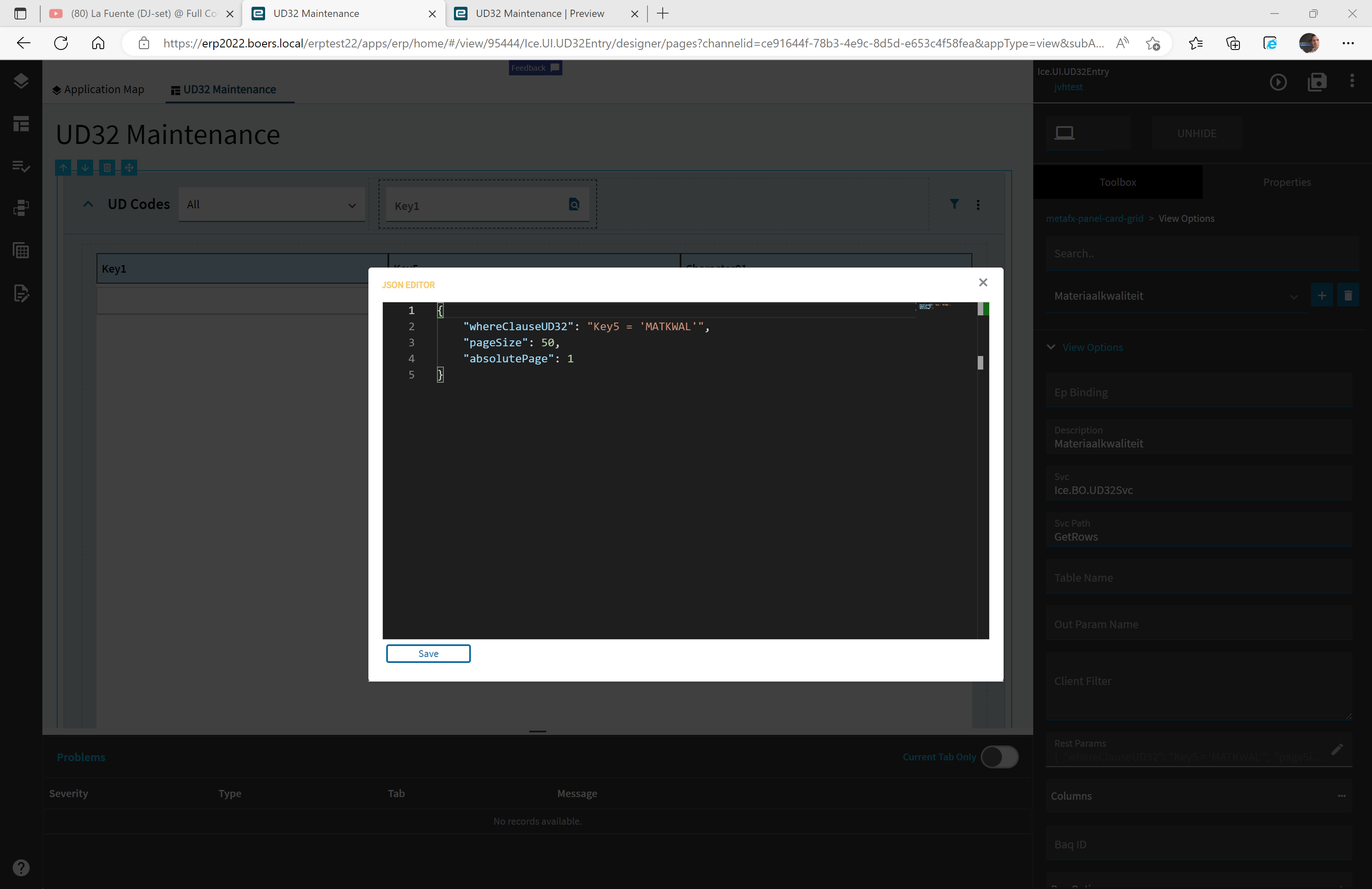

Here are the View properties:
And here are my parameters:
	"whereClauseUD103": "BY EpicorCustID_c DESC",
	"pageSize": 50,
	"absolutePage": 1
Use ASC for ascending. Make sure to set the columns in the Grid Model > Columns section or you will get eeeeeverything and it will look horrible.

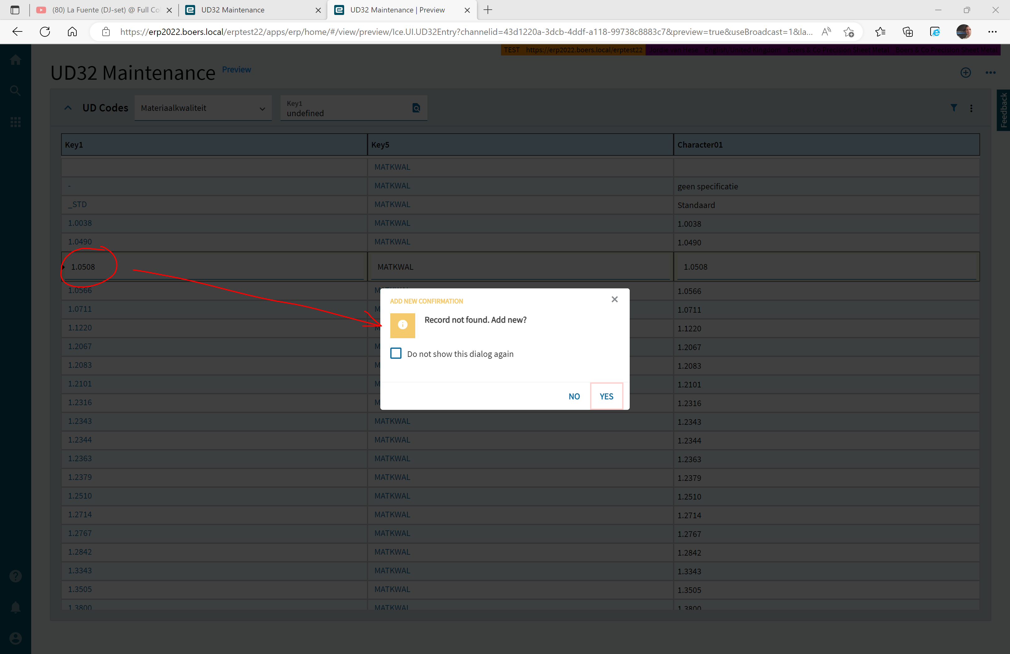

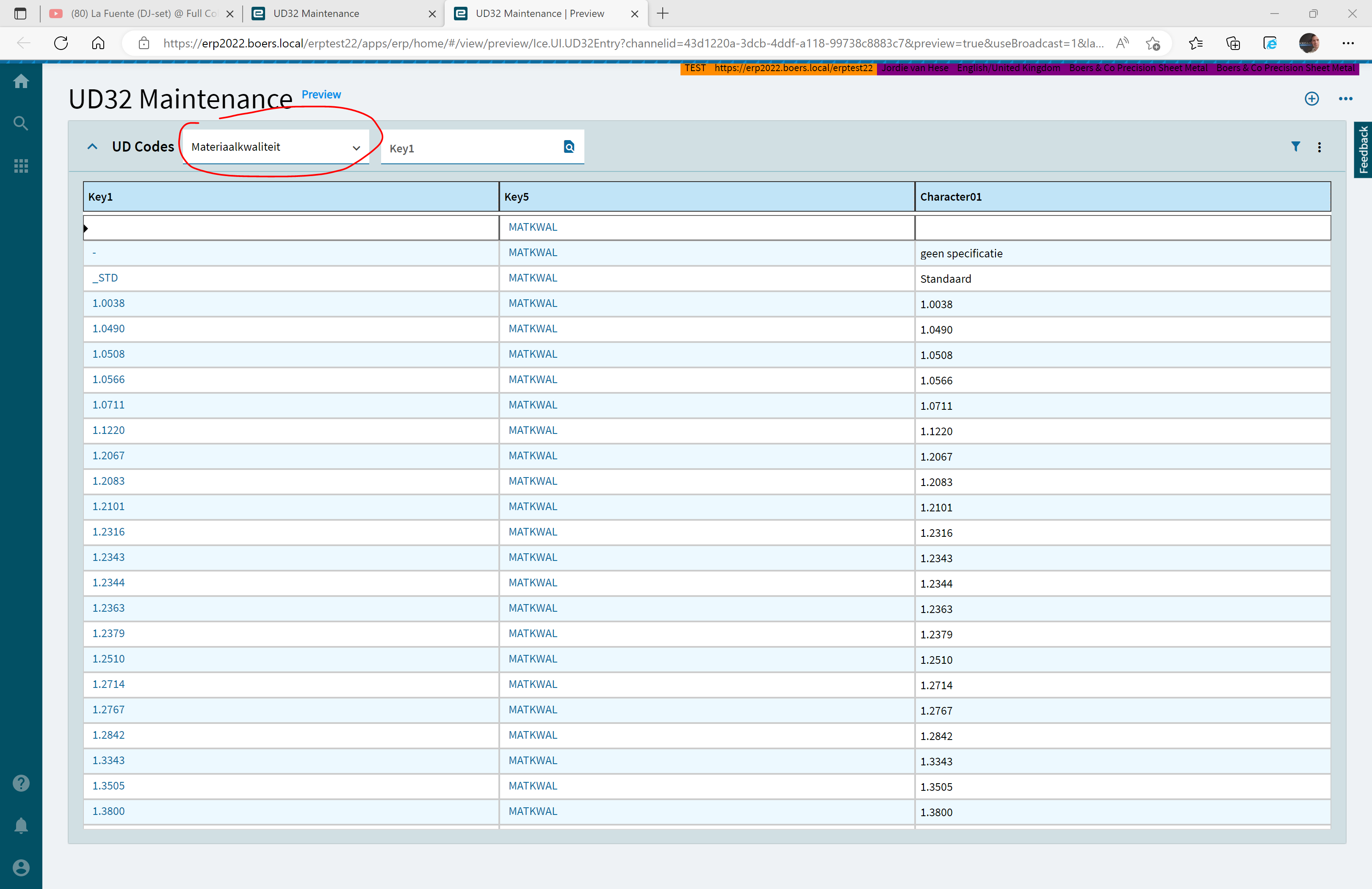

Do you know what I’m doing wrong? When I add a new value to the drop down value it won’t open UD32 records anymore.
@hmwillett :slight_smile:
Found it!

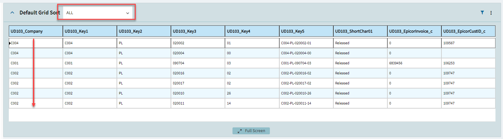

This is what I ended up getting to work to sort on more than one field…
“whereClauseUD01”: “BY RequestDate_c DESC, Key1 ASC”,
“pageSize”: 50,
“absolutePage”: 1
