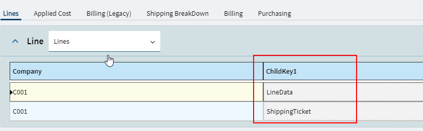

How will you be displaying the info? If it’s in a grid, you can add a panel grid to your editor, bind it to the original view, then set a row filter on it from there.
Yes it would be a grid I’ll try row filter I was using a filter widget instead of a panel grid widget maybe that’s my issue.

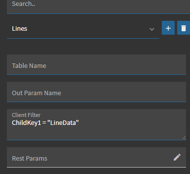

There is no Row Filter property on the Panel Grid Card… there’s a Client Filter… but syntax is … (unsure) tried Field=‘xx’ {Field}=‘xx’ {View.Field}=‘’ with no luck so far
There’s not a spot for it in the grid model? I swear it was there.
You could also try the Rest param and add a where clause.
Shooting at the hip right now as I don’t have access to a Kinetic environment to validate.
Found it, it is ClientFilter the Syntax is
ChildKey1 = ‘LineData’ (Single Quotes)
