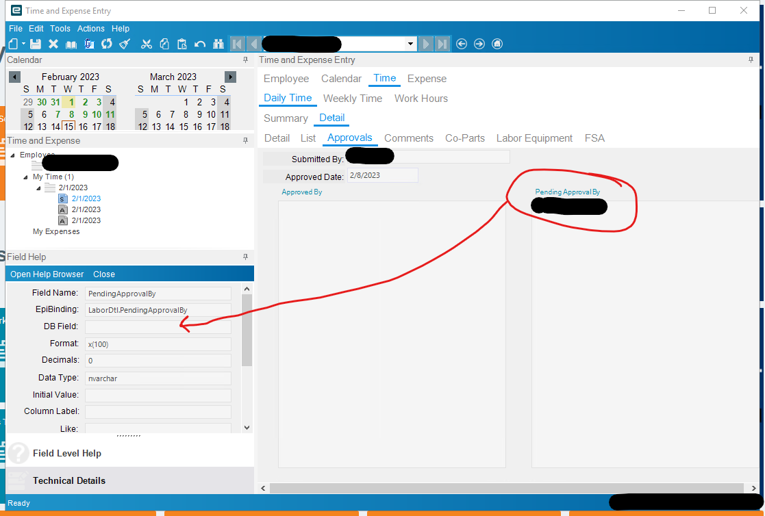

We have time approvals turned on. I’m trying to build a BAQ that shows data on labor entries. On field is proving difficult to find/map. If a labor entry has a status of SUBMITTED or PARTIALLY APPROVED, then I would like to display the name of the person currently responsible for approving/rejecting the labor entry. When I open the TIME ENTRY application and turn on Field Help, I can see the next approvers name displayed, but there is no DBField. Instead, there is only EpiBinding: LaborDtl.PendingApprovalBy. Can anyone assist in how I can get the name that appears in the approval card to show up in a BAQ?

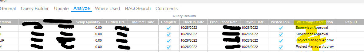

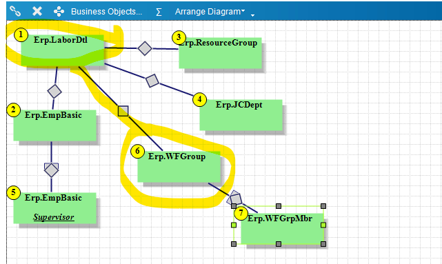

I got as far as being able to show what stage (PM approval, Supp approval, PM/Supp approval) the entry is in with the following:
But I’m still not able to pull the name of the PM or Supervisor. Can anyone help?

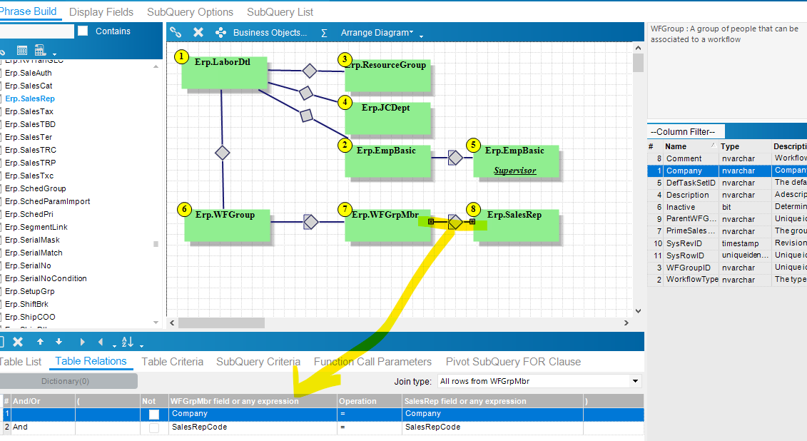

Add the Erp.SalesRep table and link on Company & SalesRepCode and you should find you names you’re looking for.

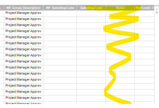

Still not working, the highlighted fields are all from Erp.SalesRep:
Maybe my joins are bad?
