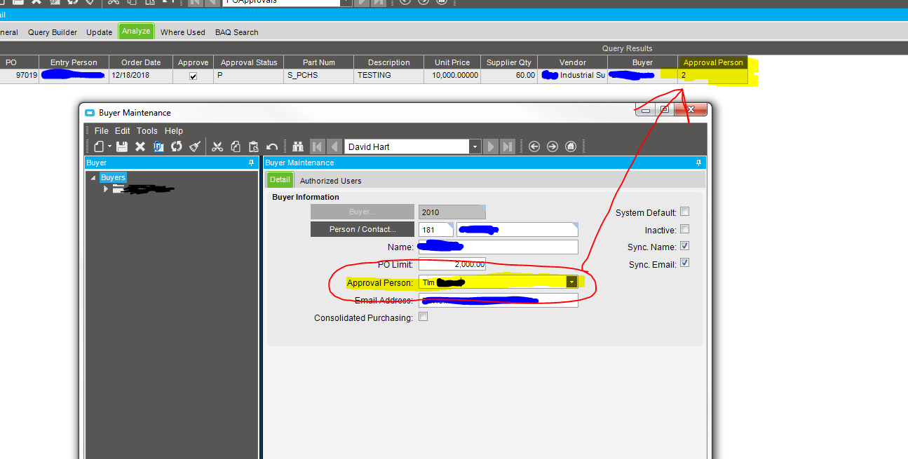

How can i get the approval person name to show up on this BAQ? Thanks!

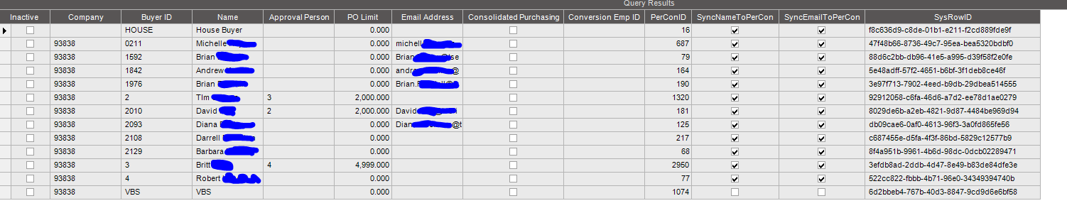

Yes, that is what i did originally.
I am connected to the buyer ID table. That approval person number in the screenshot does not match up to any person IDs.
This is what the buyer table looks like:

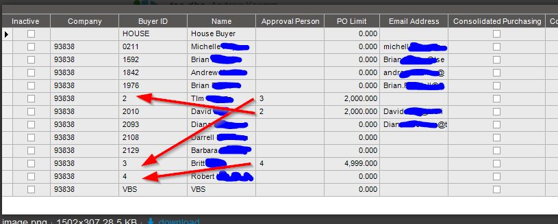

Does it match up with other buyer ID? Looks like you may have to join the table to itself. (you can bring it in twice). 2010 has an approval of 2 which is tim. Lines up with your first screen shot.
Yep, i think you are right. Dang that is trippy.
