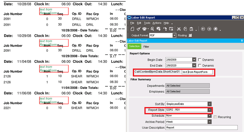

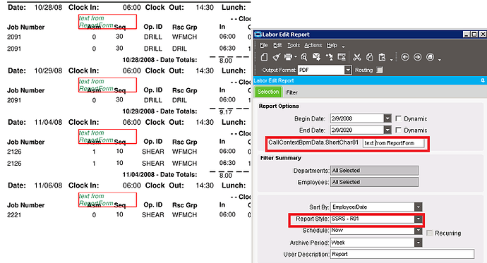

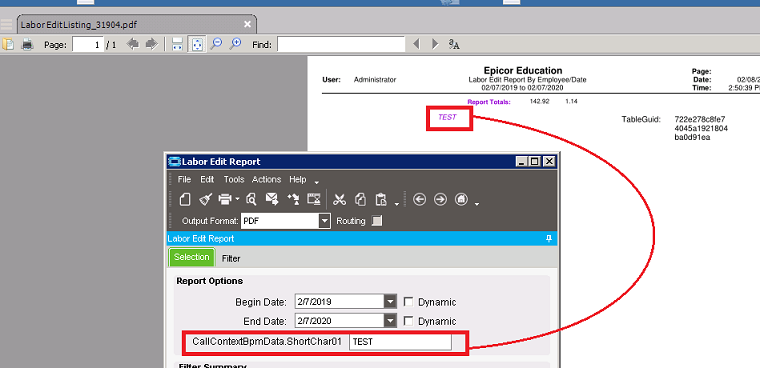

I was finally able to pass some CallContextBpmData to a report
You could have your customization auto populate the grid on the Filter -> Employees tab.
Thanks for the responses, everyone!
@bordway I am currently trying to add the Call Context BPM data. It doesn’t show up as an epibindable object once the new report is uploaded and the data set is synced. Any ideas on why this isn’t showing?

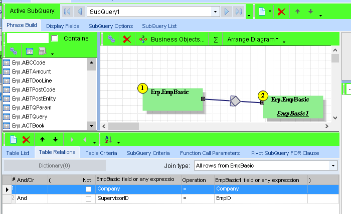

I made the BAQ E10H-EmpSuper
display columns
Add BAQ Search Like
Create the Quick Search:
Add the Criteria:
FWIW - I would get an odd error (something about number of keys) when creating the Criteria in Quick Search. I just ignored it, and everything seems to work.
Then in the Labor Edit Report form, select the Filter -> Employee tab, click the Employee button, and choose Quick search tab
Select LER01 and hit search button. You’ll see
Leaving the Super field blank returns all employees (after you hit Search again)
Enter the start of the name to filter on that supervisor
If I understand what you are saying…

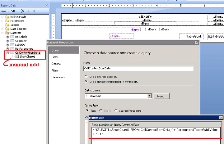

Then Yeah…, it’s just one of those things that won’t display, you just have “to know” it exists and then you can manually build/update the dataset expressions in SSRS.

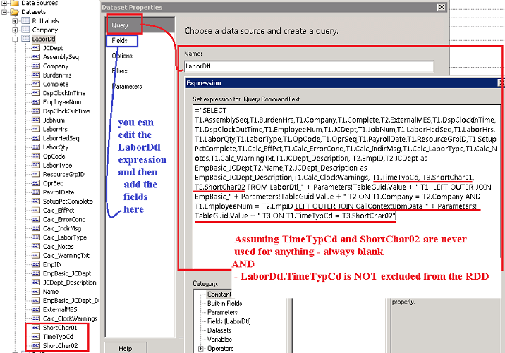

Added a couple screen shots below, where instead of a separate dataset, I was able to add the fields to LaborDtl in SSRS. A lot of fiddling for this, which is what I needed.
But… in your case, I wouldn’t be surprised if Calvin’s approach was better/simpler?
i.e. the hard way…

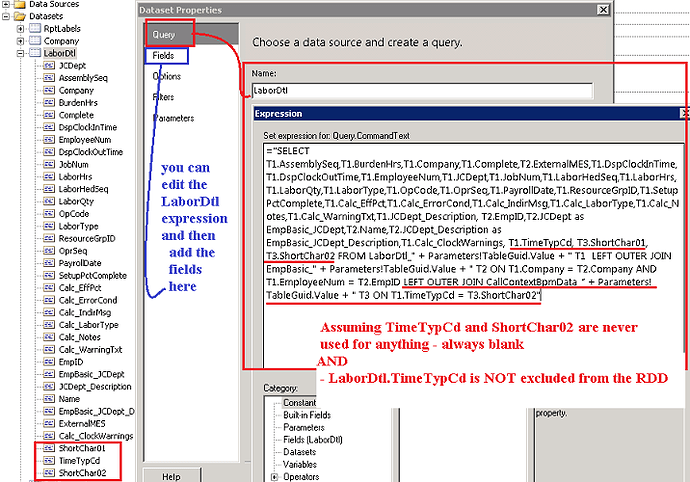

If you added fields to the LaborDtl dataset expression in SSRS

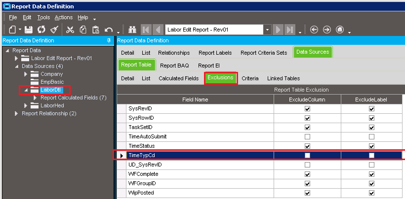

Did you also remove exclusions in your RDD for LaborDtl.TimeTypCd?
@bordway I went ahead and removed both the TimeTypeCD and ShortChar02 from the report as they were not needed. I am not backtracking through the expression for LaborDtl as the error seems to be there.
They were only needed in my case to create the join in the dataset expression.
  • where in my case, they are always blank so they worked.
i.e. this part I added to the expression:
LEFT OUTER JOIN CallContextBpmData_” + Parameters!TableGuid.Value + " T3 ON T1.TimeTypCd = T3.ShortChar02"
