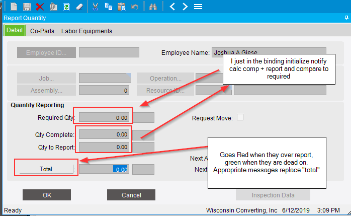

I did this customization on the End Activity screen like @jgiese.wci by adding Job as an FKV and JobOper as a sub table. I set the MaxValue property of the number control as RunQty - QtyCompleted, and I display Total Qty, Qty Completed, and Qty Remaining, for transparency.
I still get users asking me why it won’t let them enter the quantity they did.
(We decided not to do it as a BPM in case there was ever a legitimate use for overrunning the expected quantity. The quantity can still be manually adjusted in Labor Entry.)

Add a module level variable:
private EpiNumericEditor numCurrQty;
In InitializeCustomCode, initialize the variable as the number control (and remember to set it back to null in DestroyCustomCode):
this.numCurrQty = (Ice.Lib.Framework.EpiNumericEditor)(this.csm.GetNativeControlReference("f1fdcf24-066d-424e-9b59-319a804854fa"));
Use the wizard to create an event for EpiViewNotification of JobOper, and set the MaxValue there. I have a custom numeric editor for displaying the expected quantity left on the operation, so I use that instead of a decimal variable. That’s what I set to RunQty - QtyCompleted. If the current transaction is rework, I set the max value to the run quantity, so rework can actually be recorded when the op was already finished. Otherwise, I have a sanity check that the expected quantity remaining is not negative, because it throws an exception if you set a max that’s less than the min.
if ((args.NotifyType == EpiTransaction.NotifyType.Initialize)){
	if ((args.Row > -1)){
		this.numRemain.Value = ((decimal)(view.dataView[args.Row]["RunQty"]) - (decimal)(view.dataView[args.Row]["QtyCompleted"]));
		if((bool)(this.edvEnd.dataView[0]["Rework"])){
        		this.numCurrQty.MaxValue = view.dataView[args.Row]["RunQty"];
		else{
			this.numCurrQty.MaxValue = (decimal)(this.numRemain.Value) > 0 ? this.numRemain.Value : 0;
Apologies if this is unclear–it’s hard to guess what level of experience someone else has.

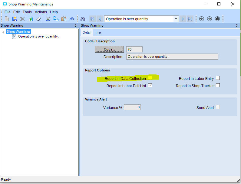

Have you tried using Shop Warning for this?
