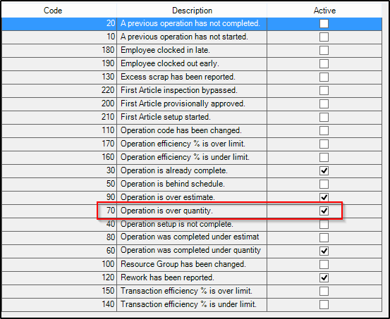

Shop warnings can do this for you.
Production Management / Job Management / Setup
Although you would need to add a BPM to Stop the entry
We have that marked, but its not stopping the end user from putting in that qty.
On the details, make sure it is set for Labor Entry. Ours is not.
Yes, the warning will work, but it won’t stop them from entering the data. You would have to write a BPM to do that.

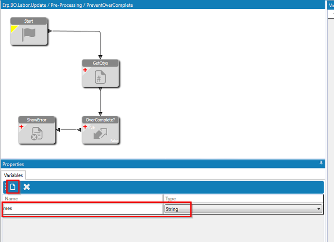

Have a look below. One of my first BPMs a while back so it may need some TLC. But it works. This is a Labor.Update.Pre. After the code runs, I have a condition block which checks if the mes var is not empty. If it’s not, it displays it in an error message.

Thank you! I’m not a coding guy so this helps. I just did a quick copy and paste and only got one error, the mes doesn’t exist in the current context. Researching how to fix that now. Thank you for the info!
Check all your quote symbols (" "). When you copy and paste it converts them.
It’s a global var. You define it in the BPM. If you plan to do this without code, you’ll probably need to add the qty vars there as well.
Sorry for the question, but I am curious. How did you tie the code into the true/false? Meaning, did the code through up a yes/no or some variable that you could then use the True/False flow?
No problem. It’s that mes variable. Those vars defined there are available to all widgets. I reset it at the start of the code and then set it only if there’s something wrong and I want to throw an error (see last line of the code). Then, I check that var with the condition widget:

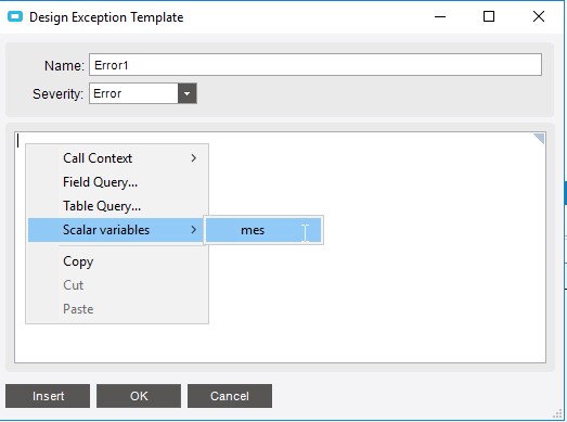

and then show it in the error message
The specific request here was to have the remaining qty in the error message. That’s why I used a string and not a boolean.
Thank you! That helped me out tremendously. I added in an extra true/false between the start and the code so it would only fire when LaborQty is being changed. Works great. Now, I’m going to go back and study what you did and learn a bit more coming! Thank you!
