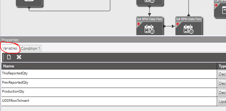

I’ve not used Set Argument/Variable very often, so not overly familiar. Curious, is this where you put these two statements in, or did you use the custom code?
Yes these 2 statements can go into that widget. You could also use the statements in a custom code block if you set them to a variable. That widget is similar to the “Set Field” one, but you can use your own custom variables with it. You create the variables just by going to that “Variables” tab after selecting any widget:
